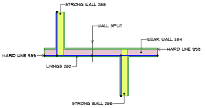

Has anyone ever managed to work out the witchcraft involved with getting the correct representation or material intersections in plan for wall composites? I’ve been trying to crack it since Archicad 17 and the only real way I have found it to create a separate building material for ever single different wall skin of each different wall type to get clean and correct intersection representation. Any tips on how you guys have worked around it would be gratefully received. (Still have fingers crossed for on the fly composite skin editing 😉 )

@Lee Hankins Depending on how you work there is a trick. Unfortunately it isn't very BIM, but it can be managed. Create your two wall types, but for the weaker one you add a line that can't be crossed using a high strength material that is as thin as possible e.g. 0.1mm so it isn't visible and won't be identified in 1mm dimensioning.
Parts of the weak wall can be flipped as necessary.
Depending on the strength of the hard line it may also project into other walls, so that's one to watch and manage by reducing the strength.
You could have two different linings with a strong and weak material but that risks creating awkward joints in sections & plans between materials and could be awkward for material schedules / take-offs.
If you use Complex Profiles you can also manage this material by turning its width on and off. But that's a far more complex discussion.

I’m guessing we work with similar constructions Lee. I set my wall cavity / air space to maximum and then diminish strengths as you move away. Given the cavity is usually continuous this makes sense to me. Internal junctions with different structures is a bit challenging, but typically plaster / plasterboard is weak and in between is really on a case by case basis e.g. studs crossing service voids. Splitting layers for wall types e.g. internal, external and different layer intersection priorities can help when coupled with display order adjustment. The only variations I have to create for wall types are usually due to finishes. Setting insulation & framing for partitions to the same strength for partitions helps.
That should keep you going for a while. It took me sometime to establish a system which works happily until someone changes the specification / wall build up..
Edit: I also aim to set the external wall reference line to the inside face of the cavity where the next inside skin is usually designated “core”.
Thanks @DGSketcher , that seems like a good method. I mostly get issues where we have junctions with higher rated and lower rated acoustic partitions where the insulation of the higher rated needs to pass through the ‘cavity’ of lower rated and touch the back of the inner layer of plasterboard.
