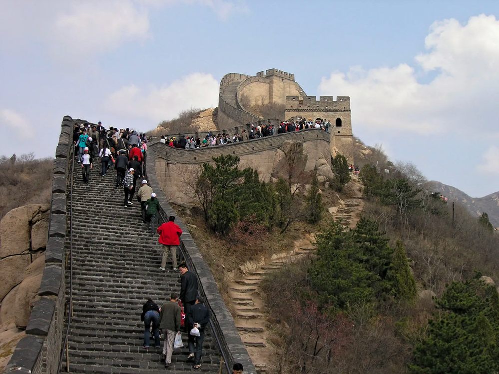

possible to make but problematic for real use - everybody is used to walk about 63 cm at one step (2*riser+1 step = 63cm). If you design Your wish - it suits just in one walking line - other places will have other geometry and the possible danger for older people to fall.
Its an old problem at quater spirald staircases for example, but there is a defined line of walking - in Your wished design - there is no one.
You can edit the steps (the step coverings - but not the stair-sturcture) . and text it with a label.
You can alternatevely design it with slabs, with morph and text it with extra Text.
A extreme example is the chinese wall - where every step and riser has different measures - and expecially for japanese tourists - its a real challenge to walk on that - seen by myself some years ago.
