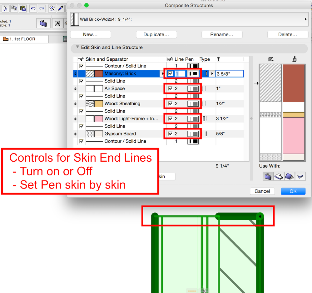

I could change the composite wall edge lines because the materials line up exactly, but what if the walls materials didn't line up exactly?

Select one of the walls, right-click and choose Edit Selected Composite. For the skins that join, turn off the Wall Skin End Lines. Do the same for the other wall of the corresponding skins only. IMPORTANT: Also, make sure the Building Materials are the same for the corresponding skins in each composite.

This works without messing with the settings in the Composite Structures Dialog.
The Reference Lines of the two Wall types should be colinear and join properly.
In this example the Reference Line of the Walls are all on the Inside Face.
In the attached image this is what I did and as you can see there is no line between the corresponding skins of the two Walls.
