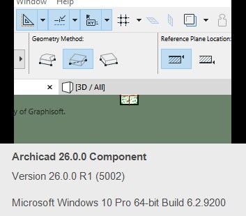

Hello Eduardo: The picture below shows how the ribbon appears on my screen.
You will note that I do not show an input window next to Snap tool icon like your does. While I can click on the "down" arrow to allow me to select "half, sections, percentage,etc) doing so does not cause the input box to appear like on yours. Is there a specific selection in the dropdown "view" menu that I haven't selected?
Thanks
Solution
Wrong icon which IIRC has that very old bug.
Activate "Control Box" under Window Menu -> Palettes.
The default W/E has it hidden by some "weird" reason.  Anybody who learned AC when the CB was part of the main W/E always removes the "improved" icon and adds back the original one.
