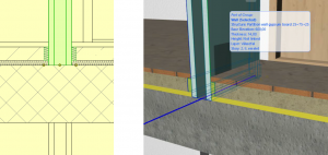

Link the floating floor screed edge detail to the joining wall
Since in reality it is attached to the wall it seems obvious to make it part of the wall by making a complex profile that includes these stripes on both sides. This might come handy later in the large scale detailing phase when even more detail needs to be added to the walls anyway.
As much as we would like to see this detail in sections it would cause confusion if the outline showed up on floorplans too. Hiding the outlines of these elements on floor plans can be done several ways:
  • set the partial display type to “Finish” and then set the Partial Structure Display of the floor plans to “Without finishes”. (Make sure that you set up all your composites and complex profiles according to this: all the skins that are not “Core” but needs to be displayed on the floor plan (e.g. insulation) should be set to “Other”.
  • forget partial structure display and set the Floor Plan Display of the wall to “Cut only”

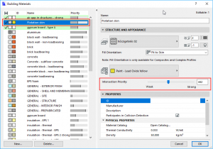

Make sure to set the priority of the insulation Building Material to be higher than any of the other floor finish skins but lower than any of the joining walls outermost skins.
The final result should look like this:

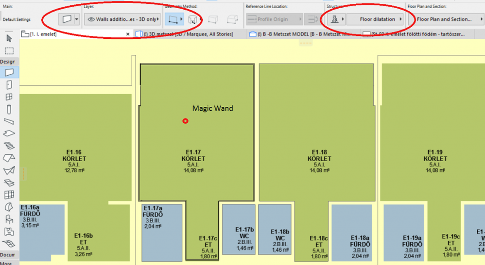

Link the floating floor screed edge detail to the edge of the floor finish (room/zone)
“Linking“ may not be the exact word - we should say “referencing” it to the edges. Simply set up a Complex Profile for only the insulation stripe. For this method a new layer needs to be introduced let's call it “Walls - additional structures - 3D only” and that layer should be hidden in floor plan views but should be turned on in Sections and in 3D views. Make sure to set the priority of the insulation building material to be higher than any of the other floor finish skins but lower than any of the joining walls outermost skins.
It is a lengthy exercise but needs to be done only once: using the Magic Wand on all floor finish slabs in the entire building.
