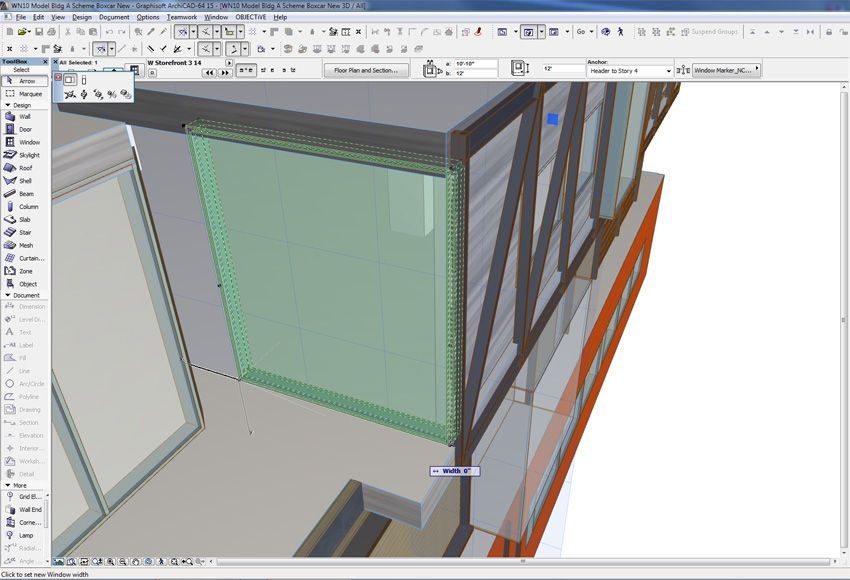

I have the following problem. After working on a file for a couple hours, it seems to be corrupting the working plane as in regards to objects in 3D.
Example:
I have a window in a wall and want to move it in 3D. I grab the endpoint and start dragging it, but it won't let me drag it parallel to the wall surface. The working plane shows correct, but the actual drag direction is pretty much perpendicular to the wall (as seen in the littel UCS).

I am not experiencing this problem. A few observations:
1. Based on the Pet palette in your screen shot, you are stretching, not dragging, the window.
2. The edit works for me regardless of the orientation of the editing plane (default orientation is horizontal, but changing it to vertical makes no difference).
3. The "Width" parameter in your screen shot reads "0", which is clearly not the case (this dimension should change as the window is stretched), so I am suspecting an issue with the window: what is the name of this library part, and where did it come from?

David,
it actually does not matter wether I use the stretch or move command. It all yields the same result. As I mentioned before, it does not happen all the time. This happens to any window or object that can be stretched via hotspot in 3D (i.e. Steal Beam) after I work in the file for a certain amount of time. It seems like the file is getting corrupted while working on it.
The very weird part is, that if I save the file in that state and restart ArchiCAD it is working fine again.
Here is a screenshot from this am after a fresh start on the file, and it is working just fine. I would bet my house that by the end of the day, it will be as the previous screen shot.
The object in this case is 'W Storefront 3 14', so nothing special. And yes, I have loaded the 14 library into a 15 file. This file was originally started in 14, so do you think that is causing the issue?
