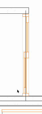

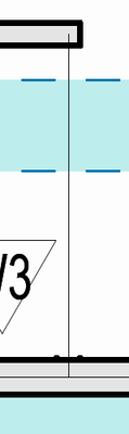

I asked about how to prevent the remnants of the wall of the structural part from remaining.

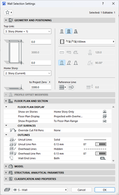

The plan view corresponds to a cut height of 110cm if you have not modified this criterion.

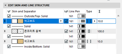

First of all you need to check the plan view of your wall. Is it "symbolic" or "projected with upper part", then it is necessary to check the display in plan of the carpentry. Also is the carpentry transom a wall or a beam? What about MVD parameters about beams? And finally because I doubt I understood your request : have you configured the structure information of your wall if it is composite?

Are you referring to this part?
AC27 on window 11
Yes
Are you able to draw/illustrate your aim ?
