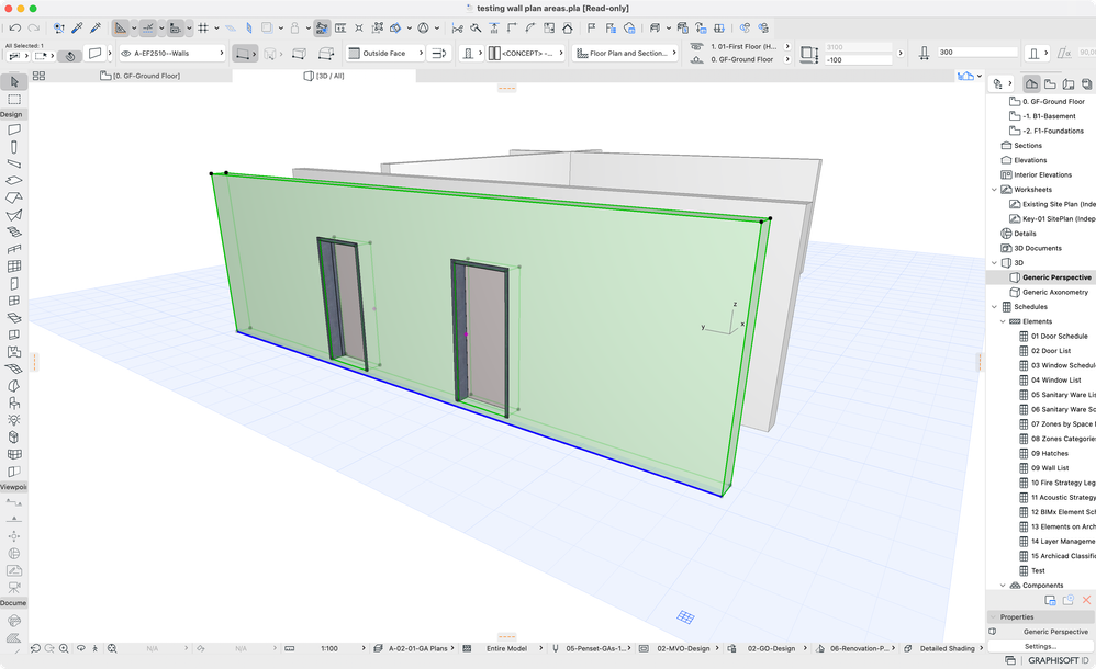

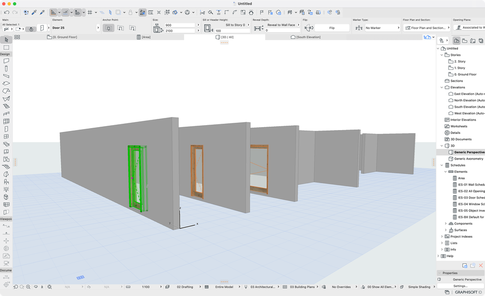

@Carlos Schwarz, I found that:
By default, my doors are modeled with the sill 100 mm to the home store, and yours are 0 mm.
So, my doors were not being subtracted from the wall's area.
As a workaround, you can model your walls with some distance in the button offset.
Hope this workaround can help you 😊

Hi @Vinicius Guedes ,
thanks for that, yes, it helps a bit. I wouldn't offset the wall by much as it would mean larger quantities for the walls, but as a "dirty" workaround I can use a sill of just 1mm and that is giving me the right area. It's not perfect though as it creates a problem with the floor's surface under the door.
Thanks for your help anyway
I will add a request for a new parameter to be added in the future (or brought back as it was there in AC18).
