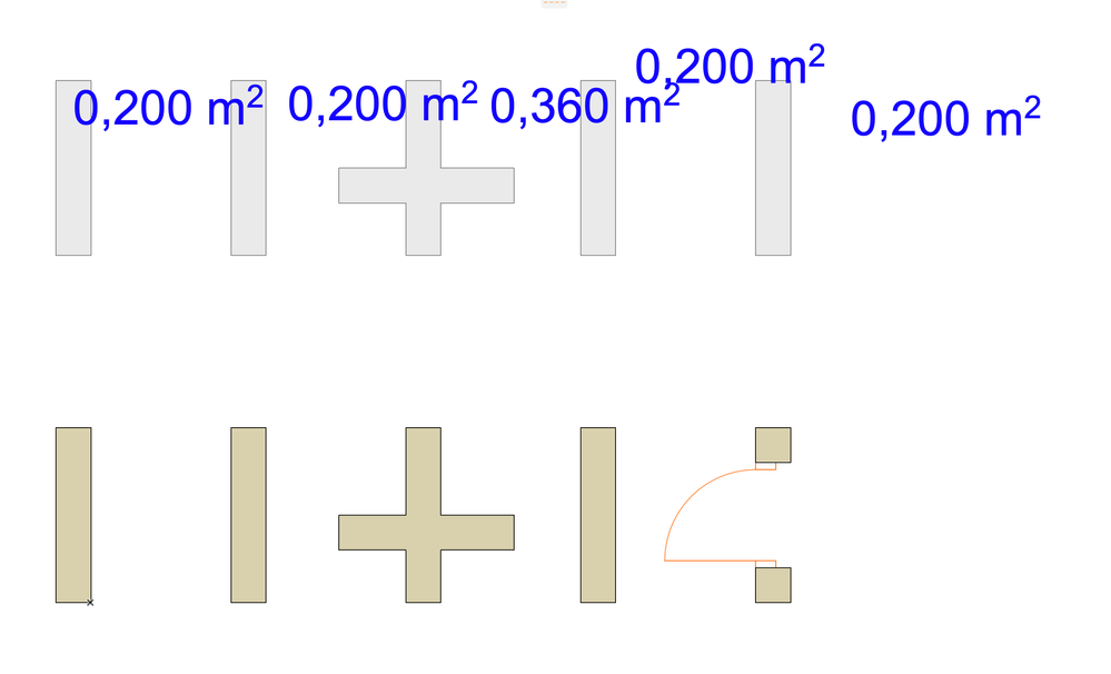

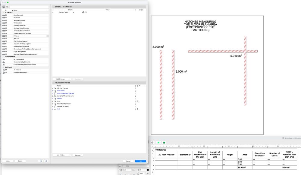

Sure, I tried to be as descriptive as possible but I guess the image helps. See attached below:
On the left you have the modelled partitions and on the right I have measured with red hatches what we are trying to list: the "partition plan area" (a projection of the area occupied but the walls).
On the schedule at the bottom you can see the results for the property "area" and for our custom property as described in my first message.

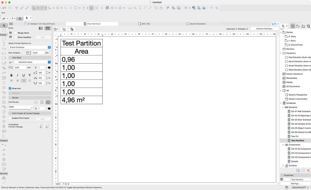

Vinicius Guedes
Graphisoft Alumni
Graphisoft Alumni
Thanks, @Carlos Schwarz, I got your point 😉
I found the correct results using the "Area" parameter in the schedule settings, as you can see in the images.
To double-check it, I created another fill schedule.
Could your share your schedule setting, so we can compare it?Screen Shot 2021-09-21 at 12.32.18.pngScreen Shot 2021-09-21 at 12.32.34.pngScreen Shot 2021-09-21 at 12.32.45.pngScreen Shot 2021-09-21 at 12.32.52.pngScreen Shot 2021-09-21 at 12.33.00.png
I am not sure how you got the same areas, it seems that your wall area calculation is not considering the wall intersection? If they have the same lenght they shouldn't be both 0,20?) I think is just a coincidence they are matching, in the hatches the walls that are crossing have a reduction of 0,04 and on the walls the wall with the door has a reduction of 0,04). Can you double check with a smaller door please?
See below my screenshots. I can send you my pln as well, it's just a quick test file.
See my screenshots

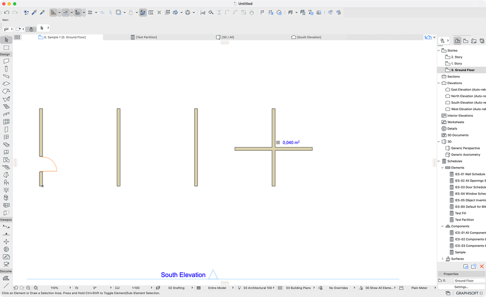

@Carlos Schwarz I double-checked, and that's what I found:
I made 5 walls, 5 x 0,20 m each, then I've 5 m2 in total.
I intersected 2 walls, and it was reduced 0,4 m2, that was correct.
3 different doors were placed and the result was still the same, what seems to fit your expectation, right?
You can share the .pla file here, via WeTransfer link, so I can check it out.Screen Shot 2021-09-21 at 14.15.17.pngScreen Shot 2021-09-21 at 14.15.23.pngScreen Shot 2021-09-21 at 14.16.44.pngScreen Shot 2021-09-21 at 14.16.50.pngScreen Shot 2021-09-21 at 14.17.30.pngScreen Shot 2021-09-21 at 14.17.33.pngScreen Shot 2021-09-21 at 14.18.49.pngScreen Shot 2021-09-21 at 14.18.52.png
