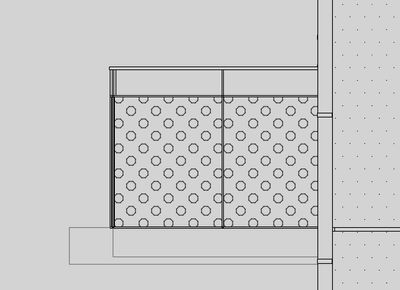

Hi, I would like to export Perforated railing panel for drawing especially for detail drawing 1:20 ( Elevation )

I would like to export and not like over-cover with fill.

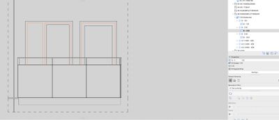

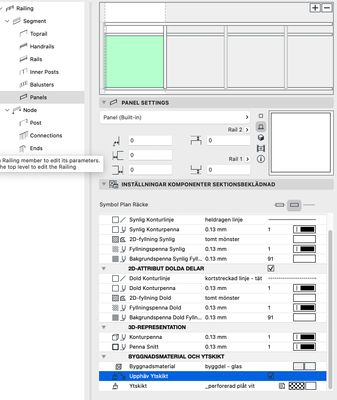

It's so har to figured out it cold be : Graphic Override, Material, Texture, Railing settings, Building material, Elevation settings - new function with showing ( Cut and unCut material )
I went trough all this settings but I couldn find out. Any advice where  I should look ?

This Railing is from normal panel which has Perforated texture .png I know it's not modeled but I feel this is better solution how to work. I would like to preset some fill which go automatic whit railing or texture.
I did this for normal elevation but this is not good for detail at all, also I can't figured out how show fills in detail

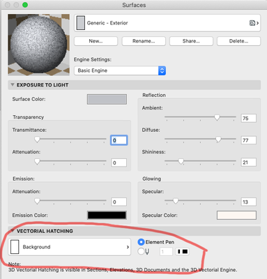

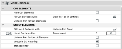

I have tried this a few time myself.  Using a fill / hatch for elevations may be a good option for you.  In order to get that to work the elevation or section marker needs to have the Vectorial 3D Hatching box checked:
You set the fill for Vectorial 3D Hatching in the Surface Settings.
You will probably need to create a custom Symbol Fill to use for this.
