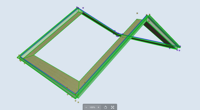

I kind of got it working with a railing. With zero length direct connections, deleting the kinks cleans up the connections nicely.
If you are wanting it to be associative along gable ends, you will need to use single pitch roofs as you cannot associate with the ridge for some reason, while you can associate with every other node... If you do not mind fixing the ridge point each change then there is no issue with using a multiplane for gables.
One flaw in the railing tool is that it would seem that you cannot make an enclosed railing, so you will have the add an extra node of the edges in order to get it to appear continuous.
Ling.
I was just playing with it myself and discovered the gable ridge problem too.
I even managed to get the transition at the corner when the side profile remains vertical.

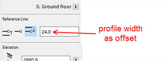

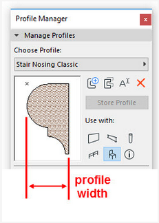

It seems to work best if you use a profile with the origin on the outside of the profile (for testing I just used the stair nosing profile).
Use the profile width as the offset for the railing.
This will move it out from under the roof.

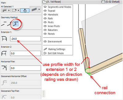

Set the rail connection to a 'Direct Connection' and use the profile width for extension 1 length.
You may need to do this for extension 2 length depending whether the railing was drawn clockwise or anti-clockwise.
