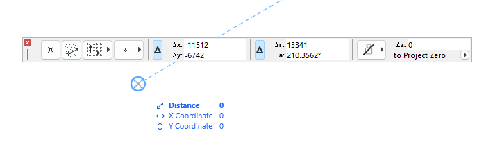

As you place elements, a temporary User Origin is placed at the starting point of that element and then you can specify the length of a wall or slab or beam, etc.

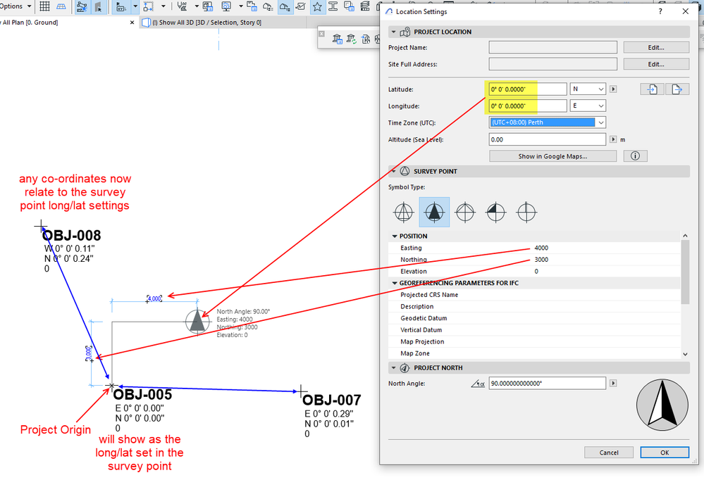

You can place the Survey Point at any distance in relation to the project origin - that is the easting and northing values - simply the X and Y distance you want your model to be from the surveyors control point.
You then set the longitude and latitude in the survey point for your known location.
The project origin will now effectively become that longitude and latitude.
So now any part of your model that is at the project origin will effectively be at your known surveyor's control point.

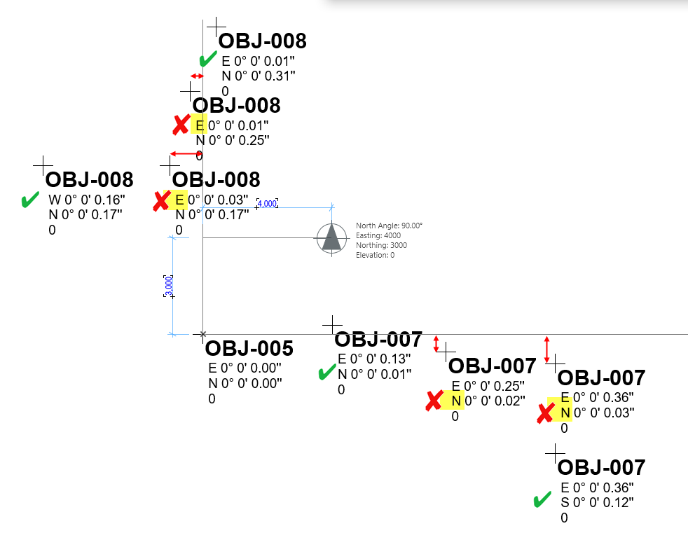

You can see here I set the survey point to 0 longitude and 0 latitude.
Any co-ordinate that I check will be measured from the project origin, but will show the co-ordinates in relation to the survey point long/lat settings.
Although I do notice a slight error when crossing the 0 long/lat lines.
Shouldn't be an issue when yo set the correct long/lat.
