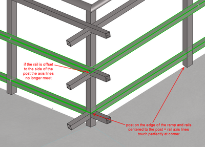

You are correct, only if your railing posts and the rails are centred on the reference line of the railing (the edge of your ramps), will the rails join perfectly at the corner.

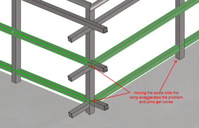

By offsetting the post onto the ramp, you are adding half the width of the post to the length of the rails.
And by offsetting the rail to the side of the post, you are adding the width of the rail to the length of the post.
Then the centre axis of the rails will no longer meet at the corner without a flat transition length.
So now you need a transition zone on the rails to make the join.

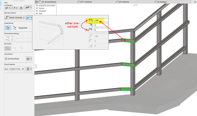

Use the direct connection and put a negative length to one side to create a flat transition.
I just guessed -200mm - you could measure it exactly on an elevation.
But the connection is still not perfect if you look closely as the railing twists.
A gooseneck connection give a better result.
If you don't want the vertical portion of the gooseneck it will be a bit of trail and error or measuring in elevation.

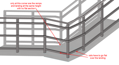

As far as I can tell there has to be a flat transition if your rail goes out over the flat landing.
Then only time it doesn't, is if the rail is centred over the edge of the ramp where there is one point at the very corner that is the same height for both ramps and the landing with no flat portions.
As soon as the rail is offset out over the flat landing, then if the rail is to be all at the same height, then it must rake up with the ramp, go flat over the landing and then rake up with the next ramp.
It is physically impossible to connect 2 rails parallel with each ram as they just won't intersect.
Take the extreme and let's assume the railing is on the other side of the ramp.
The rails must go flat when they get to the landing.

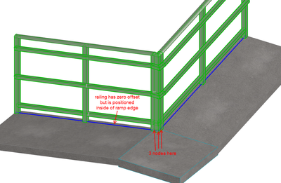

That made me try something.
Model the rail with no offset but position it slightly inside the ramp edge.
Add the 3 nodes as it transitions around the flat landing.

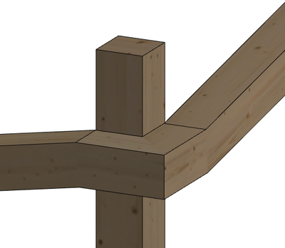

Then turn the 2 outer posts off, leaving just the rails and one corner post.
The top 2 rails are offset to the side of the posts and now wrap around flat (direct connections with zero extensions).
The bottom rail I left with no offset.
This is what I would expect the rail to look like.
