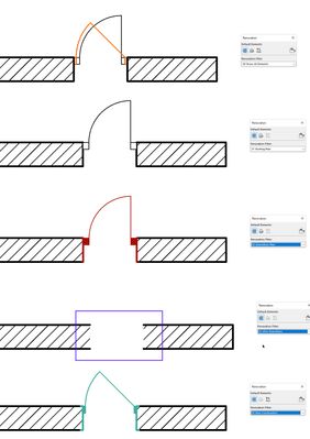

Hi.
All is good except new elements are displaying walls while I have only doors to be demolished, I don't want that opening to be filled with wall after door is taken out of wall, it should left the passage in idea.
First is existing plan and is ok
Second is door which is to be demolished and is ok
Third is after demolition and is ok
But fourth one is not ok , why it behaves like that ? Thanks for help !

2022-02-25 01:51 AM
If your were to simply delete the door, Archicad would heal the wall.
I guess the renovation filters are doing the same logic.
You are demolishing the door so there needs to be a new wall to fill the gap.
You could split the wall either side of the door and demolish the whole wall and door.
Or add in a new opening.
If you were modelling it all as new you would be doing the same thing.
Either two separate walls or a wall with an opening.
So when using the renovation filters you still need to tell Archicad to demolish the wall or add an opening.

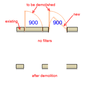

But I still have a strange behavior, will show that:
"after demolition" state is hiding the wall width lines as you can see, why it behaves like that?

I don't use the renovation filters very much.
I assume the side lines are missing because you have a new door going in that space.
In my image here you can see the door on the left is not being replaced (by another door - but Archicad will add a new wall automatically).
The door on the right will be replaced with another door - so that is probably why the side lines are not there.
I can't see any settings to make this any different.
I am inclined to agree with you that the side lines should show though.
