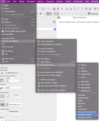

Hi there,
I have made a hit-and-miss brick screen with the curtain wall tool, I was wondering if anyone knows a workflow which could rotate the bricks to allow for angled view lines rather than perpendicular to the wall. Reference image attached although I'm not trying to get too complex and I'd be happy if I can rotate everything to the same angle (I imagine to create a parametrically controlled wall with varying rotations I would do it via grasshopper which is overkill for now).
Many thanks for any insight.

I made a param-o object for this:
https://drive.google.com/file/d/1s6KfEKZ02YcvyHcFqpyx_06ElFRrgohz/view?usp=sharing
You could do this with a curtain wall but the stones will be cut:
Draw a roof, save it as a panel: Library and objects/save selection as/curtainwall panel (dutch version)
Apple M1 Max 32 GB Ventura
AC27

I didn't have much success with using the roof plane as a rotated element. Is the theory that the angle of the roof then translates to the angle of the brick via a perpendicular plane?
