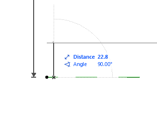

2022-12-21 03:34 AM
Hi Ling.
I'm late in contacting you.
thank you for your answer.
I was able to resolve the issue by changing the dimension type.
I've attached an image of the dimension type change.
The reason I didn't use the horizontal guideline of the stretch box was because I wanted to control the shape with dimension values.
