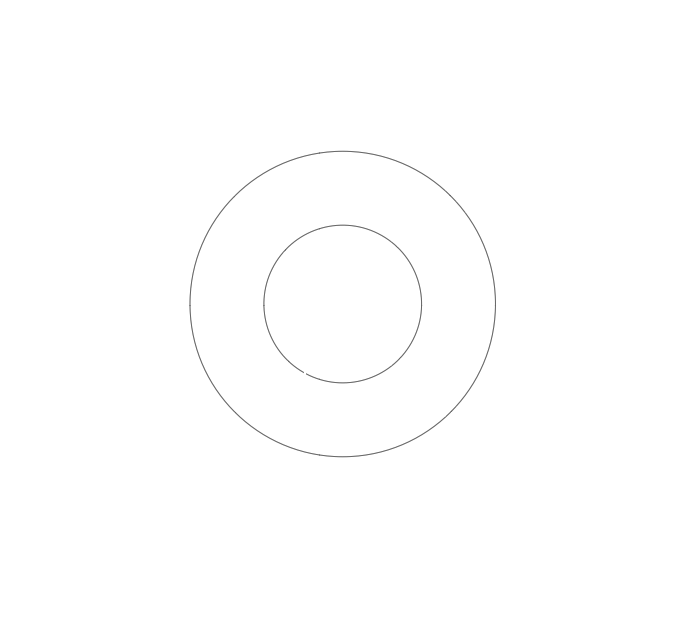

  • Draw two concentric circles, d1=1600, d2=3100.

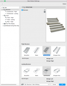

  • Select the Stair Tool, open the Stair Settings Dialog and set the following settings:
  • Go to the Structure option and set both Flight and Landing structures to Cantilevered.

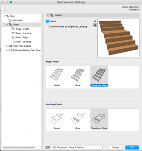

  • Go to the Finish option and set both Flight and Landing finishes to Tread and Riser.

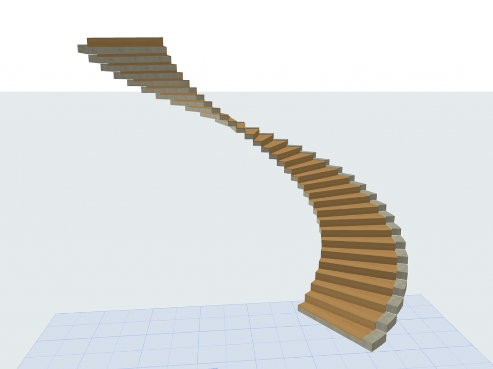

  • Draw Stair using the Magic Wand. See the video below:

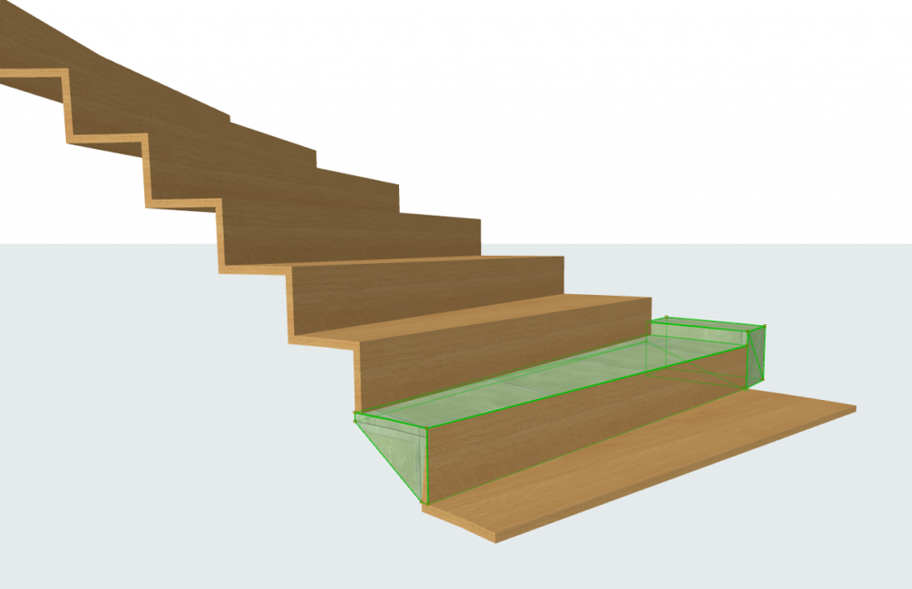

  • Delete all but one Tread and wall Fixing, and adjust the size of both  using the dragged copy of the Stair as reference - raise Tread to the level of the top surface of the Finish, pull out the vertical plane to the surface of the Riser Finish and adjust the size of the Fixing accordingly.
  • Delete the Stair you used as reference.

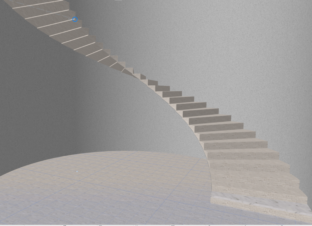

The resulting Stair:
