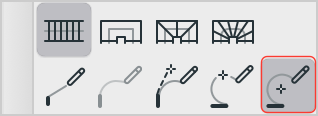

  • using the Magic Wand
  • using the 'Arc by Centerpoint' command from the Pet Palette during the input

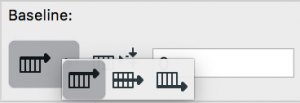

  • Make sure that 'Right' is set for the Baseline in the Infobox.

  • If you select 'Left' for the Baseline position the Magic Wand will place the Stair on the outside of the circle:

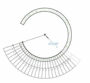

Using the 'Arc by Centerpoint' command
  • Activate the Stair Tool.
  • Click to start the input and select 'Arc by Centerpoint' command from the Pet Palette.
  • Define the centerpoint of the spiral Stair.
  • Finish the Stair with a double click.
Important to know:
  • The radius is always measured from the Baseline (blue line), so choose carefully the position of the Baseline on the Stair. See the different stairs resulted by different Baseline settings (notice that the radius is the same):
  • The first click defines the starting point of the Stair.
