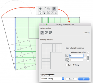

Turning stairs can be constructed in 2 different methods: using turning type method or segment type method. Let's have a quick look at the main aspects of those two types.
Turning Type

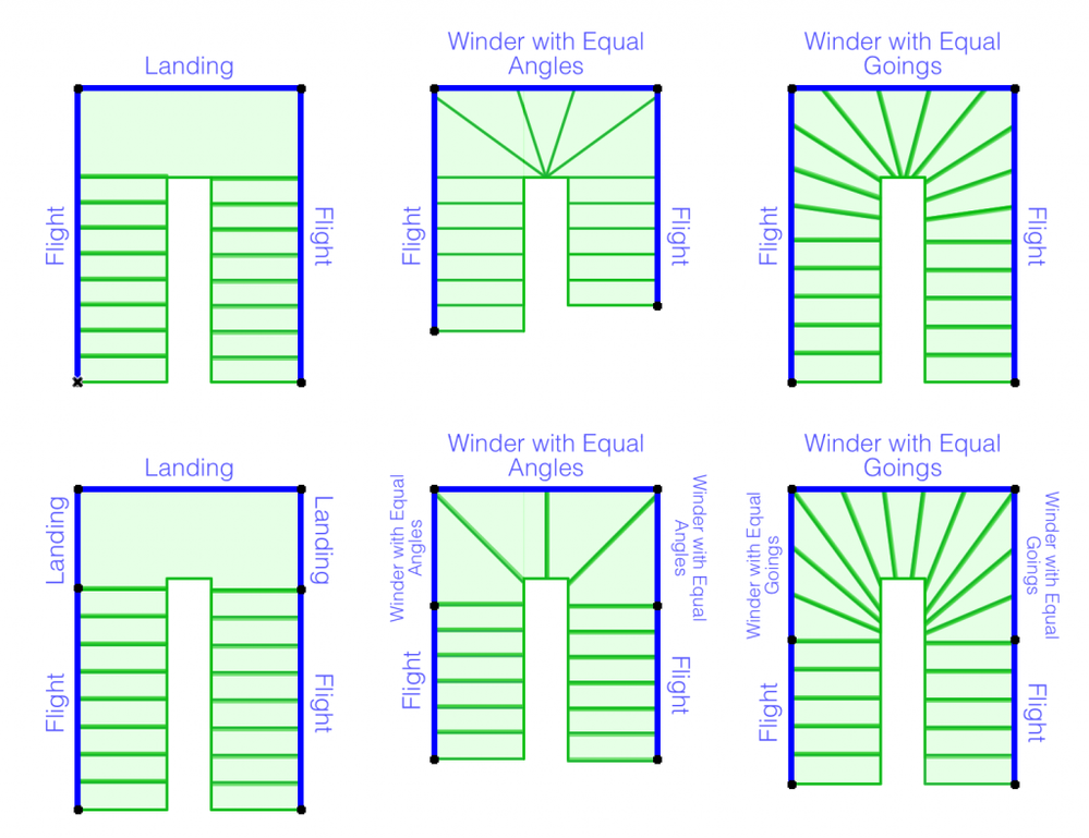

Turning type can be used in 3 ways:
  • Landing
  • Winder with Equal Angles
  • Winder with Equal Goings

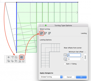

You can change the Turning Type from the Settings dialog / infobox as well, as long as your stair only has one type of turnings. If you have different turning types in a single stair (eg. a winder and a landing), you can change the settings of each turning separately, if you click on the corner node, and select Turning Type Options from the Pet Palette.

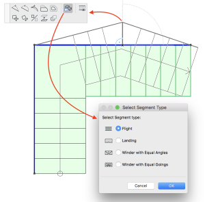

Segment Type
Segment type method is composed of segments which can be defined during the input or afterwards. There can be several options combining segment types:
You can find more information about Stair segment types here.
Summary
The changes which you would like to make afterwards can be done by dragging different parts of the stair.
  • To change the Turning Type of the Stairs you have to click the corner.
  • To change the Segment Type of the Stairs you have to click the Reference Line of the Stairs.
