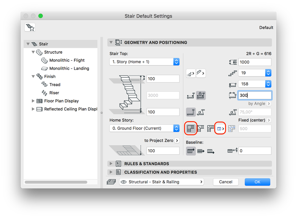

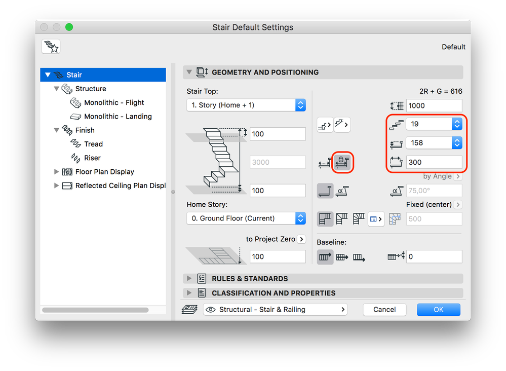

  • Activate the Stair Tool.
  • Open the 'Stair Default Settings' and make sure that the following settings are used (Story height: 3000 mm):
  • Click ok.

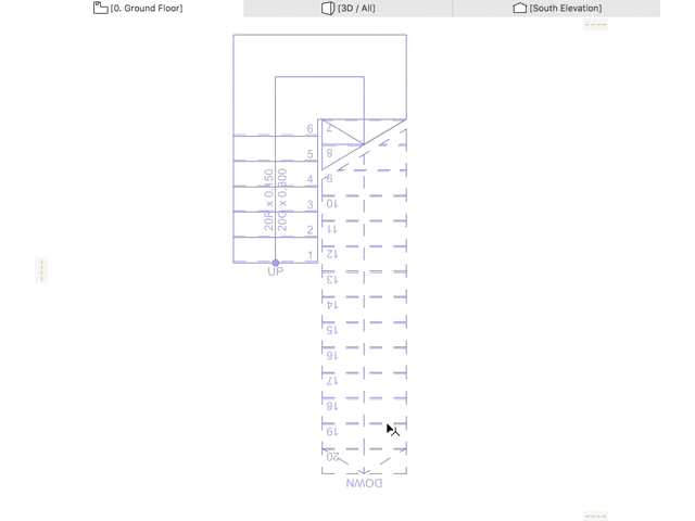

  • Click on the floor plan to begin inputting the Stair.
  • Start drawing the stair and do a click when you about finishing the first flight (the ghost feedback helps you in that).
  • Select the 'Landing' from the Pet Palette. Move the cursor into a horizontal position.
  • Do a click when you satisfied with the length of Landing.
  • Now select the 'Flight' icon from the Pet Palette and do a turn.
  • With a double click finish the Stair.

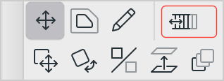

Let's make the flights equal:

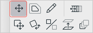

  • Two buttons of the Pet Palette can be used for that purpose:
    • 'Rearrange Steps'
    • 'Stretch'
    Rearrange Steps Stretch
    • Both options will appear if you select the Stair and you click on the hotspot of the Baseline (blue line).
    • Select the 'Rearrange Steps' from the Pet Palette and stretch the flight until both flights having the same number of steps (follow the ghost feedback).
    • Click on the endpoint of the Baseline (of the shorter flight) then select the 'Stretch' command from the Pet Palette.
    • Stretch the flight until it gets the same length as the other flight (use the Snap Guides for help).

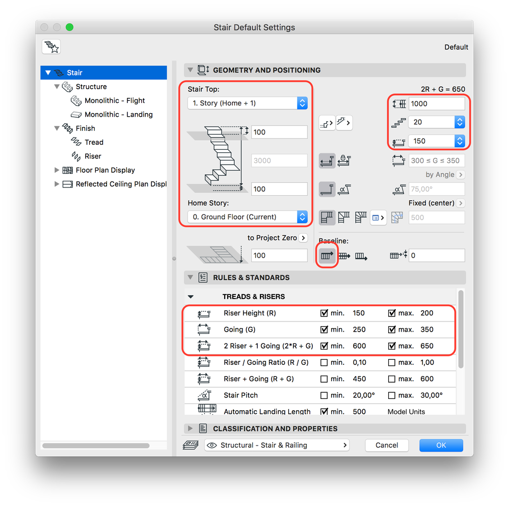

    • Open the Stair Default Settings and do the following settings (the same rules have to be applied as in the previous example):

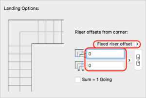

    • Select 'Landing' as the 'Turning Type' and open its setting dialog
    • Do the following changes:

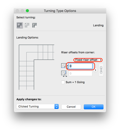

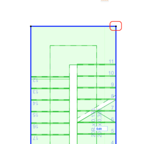

    The offset for the turning can be modified even if the stair is already placed.
    • Select the stair
    • Click on the hotspot of the Baseline (blue line).
    • The 'Turning Type Options' dialog will appear where you can add an offset from the clicked corner
    • Click ok.
    • Select the other corner of the stair on the floor plan.
    • Select 'Turning Type Options' from the Pet Palette
    • Do the same setting and enter the same value.
    • Click ok.
