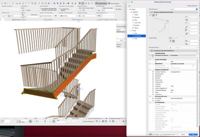

Hi I have problem to make nice straight sides "beam" of staircase.
When I use it generate from settings they are not straight šŸ˜• I know that this is generate from staircase settings and steps, but I don't wanna this following I wanna more like simple.
The blue lines are how I would like to get -simple and streight

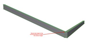

I tried to do with beam tool but i don't understand the connections with other beam why this "corner"  have this:
Do you know why this happening ? I tried to change ending of beams but didn't work.
My last try was to make with railing tool but very similar resolute like staircase generated "fligt"

This is the normal way to create this type of stair silt. Any craftsman would build it this way. Curves make it possible to hide the noses and under steps cleanly and regularly, with the same gap.
For your Beam intersection problem see attached.ā€ƒ
ā€ƒ

Regarding the railing option, in EDIT mode, try deleting the connection piece.
Thanks I see why this how it is.
I just wanna have more freedom for design of staircase.
