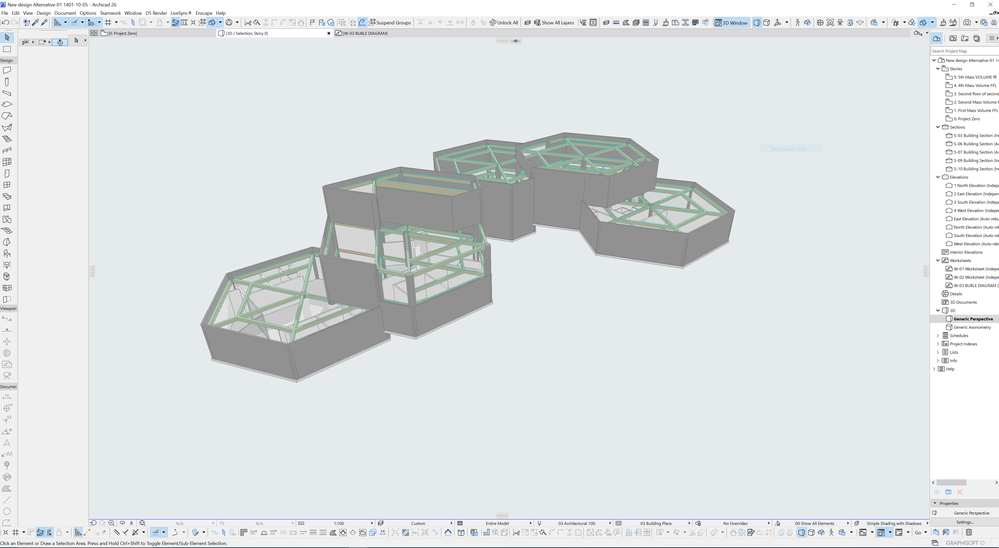

I would like to know how I can Set-up Story Settings in a Project with 4 Different Levels of ground Floor in an sloped site!
The images of Priminilary 3D Massings and Volumes of this project is attached!

This split-level model/documentation feature has been requested many times in the past, many of us hope that it will be implemented in the (not too distant?) future.

The short answer to your question is there is no possibility to create this kind of request with the home story. My suggestion would be to use the hotlink modules.

I would set your stories based on the documents you want to deliver. If you want to deliver a single floor plan then I would do it all on one storey.
Then you will need to adjust the storey cut plane or set all of your walls to symbolic cut.
Nathan Hildebrandt fraia

As you requested to know, my intention is not only the 3D Model itself! Because it is possible to make the 3D model even using one Story level. I wanted to know if there are some tips and tricks to have different stories to get continuous Floor Plans passing through 4 different levels of Floor Plans each of them 150 cm above the bellow Floor level.

As you might have understood through looking at the attached screen shots of my request, we have 4 different Ground Levels for the whole Project each of them 150 cm upper than the bellow volume!
If I use only 1 Story for all the elements, what happens if I would like to have plans on the upper floors of each of 4 main volumes of the Project?

If you want an upper floor you do the same thing. Pick a level (height) you want to start each floor from and then offset the start height of each wall if you want them to be all on the one plan.
just remember to set all of your walls to symbolic cut. It has been a while since I have never tried to display a single plan or storey that has 4500mm in total variance before. The windows and door may not appear correctly even with the walls set to symbolic cut.
If that is the case a module method may need to ve used.

I think GS should consider this issues in the up-coming releases of Archicad and it seems if they consider something like Zones or Regions for Story Setting Dialog Box, then we can easily use Archicad for the Projects which require different levels on Floor Plans!
