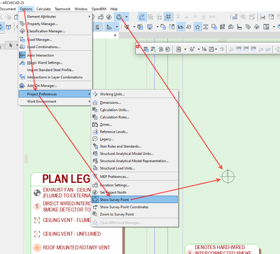

what is this symbol that just popped up in my Archicad. what key did i hit to bring it up and what key to get rid of it it seems to do nothing . if it is hard to see in teh pdf its a circle with a triangle in it and cross hairs

That is a built in base survey point. You can hide it via drop down menu on default toolbar.

Thanks I did finally figure it out it wasn't easy to turn it off not really sure how i did to be honest. I've never used that feature since I like the control I have over an object north
And it won't print.
thanks unfortunately i don't have the default tool bar on so getting rid of it is by chance and it seems to be popping up without input from me that i can tell.
