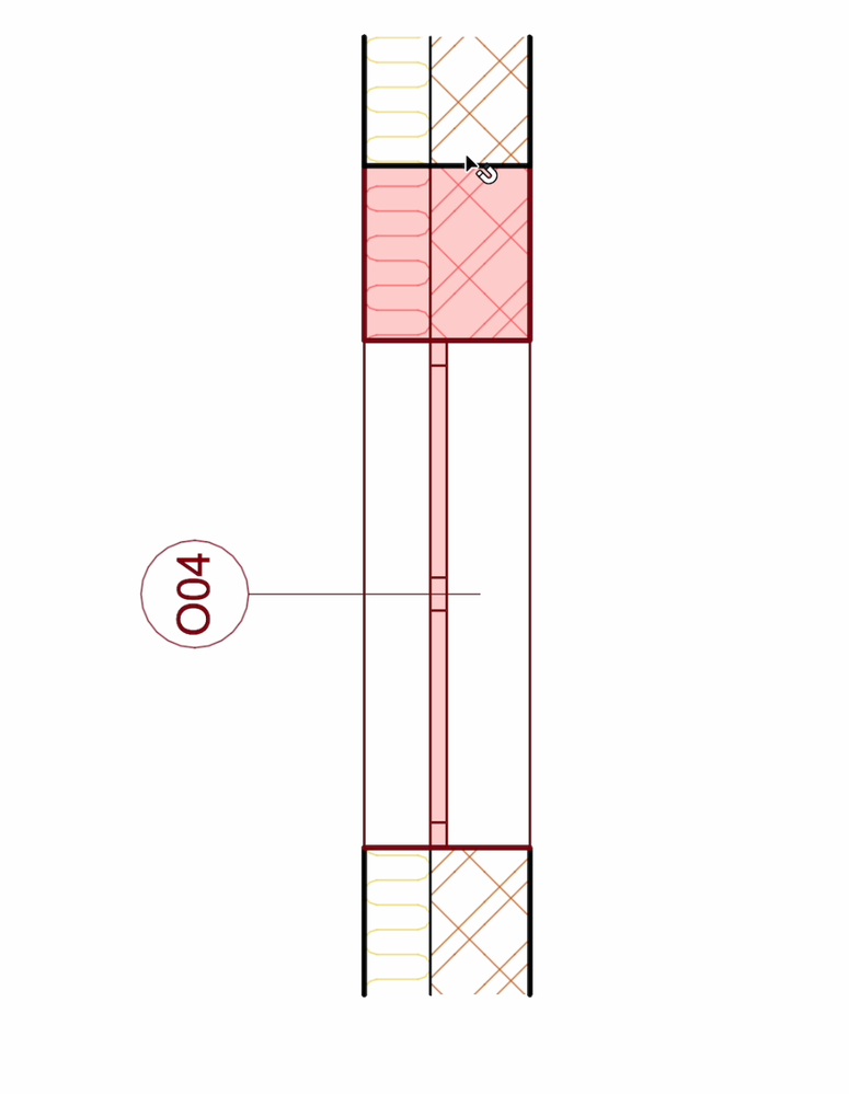

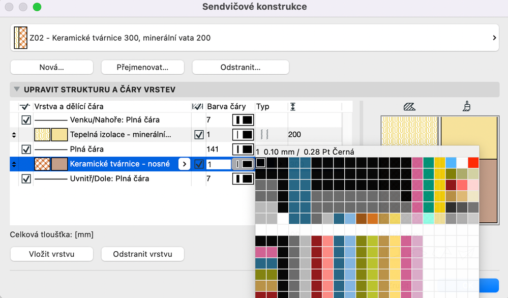

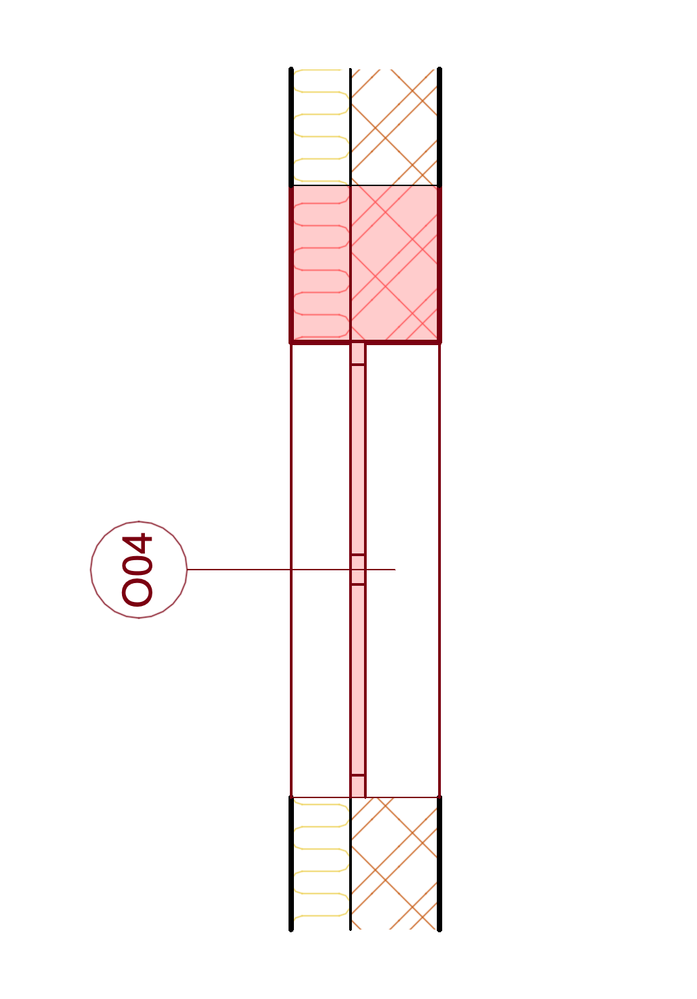

does any of you know how set up Line thickness of Composite at Opening window? I have existing composite wall and one to be demolished window and one new window (pic01). When I set the end line of the composite as 0.1 mm (pic02) and show the view as New Construction filter, there are still one line which has original thickness (pic3).
Is there any possibility how change only line thickness between new part of the wall and existing part?
