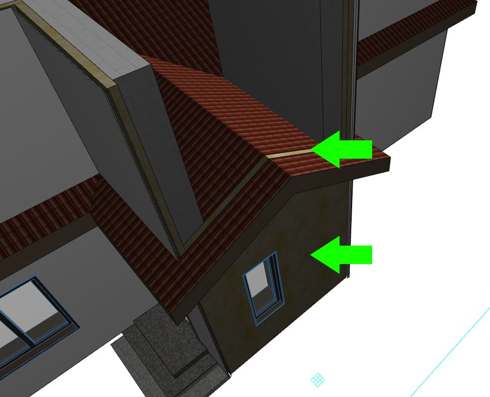

When trimming a wall for the roof, the finish of the wall disappears, and the roof remains a strip of insulation from the wall. What to do?

Check your Building Material Priorities. Ensure that your insulation does not have a higher priority than your roof.
Options => Element Attributes => Building Materials...
