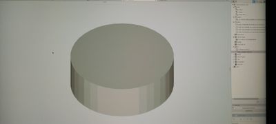

Hello guys!
It is my first post in this precious forum. I am starting to use Archicad after many years of Revit. And I'm a bit panicked 🙂 For example, using the Morph tool, I found that the program, drawing a cylinder, creates a surface divided 36 times, therefore polygonal! I saw that if I have to fillet a corner of a solid, you can choose the number of segmentations, that's a good thing, but the cylinder remains segmented ...
Tell me it's not true, tell me it's just my mistake, it's not possible that in 2021 such expensive software still has this problem.
Thanks!

The cylinder always remains polygonal, apparently it is a choice of Graphisoft to have a faster and more responsive program ... and this is a good choice. The second problem was my problem! When I opened the Elevations settings, I didn't select any Elevations, and so the program set ... the next few elevations, not the ones I already had! Which in fact never changed!
Basic rookie error...
Thanks all for the support.

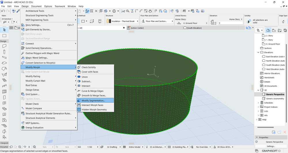

To increase the number of edges, go to Design -> Modify Morph -> Modify Segmentation... and activate the double segment option for faster action, repeat these steps to increase in several more times.

OK, your suggestion works perfectly for objects made through the Morph tool.
But this "segmentation" unfortunately also exists in architectural objects, cylindrical columns or curved geometry floors ... If I make a column, inserting the parametric column present in the Archicad library, its generating circle has 36 sides, and not there is no way to increase them.
A friend suggested to me a way, but not completely decisive: enter the settings of the "magic wand" and enter a much higher value of the segmentation of the curves. Consequently, if you make a circular slab for example, just make it using the magic wand tool, and its edges will be perfect. If you do it normally, its edges will be polygonal.
What a pity 😞

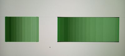

RevitRevit20210927_200147.jpgTwo slabsTwo slabsTwo slabsTwo slabs
Approximation, you can't do without it. Yes, it makes it difficult to visualise small architectural forms, but with smoothing (I hope you removed it for the example) and visualising the exterior at a certain distance, this aspect will not be noticeable.

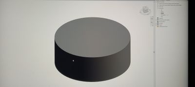

In the 3D display presets there is detailed shading, selecting this option causes objects to be smoothed.
View -> 3D View Options -> Detailed Shading
Proud member of UNION.ARCHI Network
Unabend
I was in Detailed shading mode! No difference, because is the object "construction", not the shading that makes difference... If you see the same object in Wireframe, you will see the "grid" of 36 segments of my cilynder column 😞
