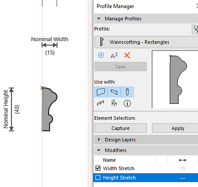

I'm trying to add custom sized wainscoting to my walls. I've managed to create custom complex profiles which are working more like cornices which you can draw on 2D floorplans. I can't get them to go vertically, only horizontal. I'm drawing them on a 3D perspective. Ive tried setting them up as a beam and a wall.
Ive also seen another tip about using a rail with Wall profile 22 but it's not an option on mine, I'm using ArchiCAD 26.
What's the easiest way to do this?

In the Profile Manager, click the Column icon in the Use with: section, save the profile, then use the Column Tool to place the vertical elements of the wainscoting. To use the profile as part of a Railing, click the Railing icon.

Thanks David, appreciate the tips. Ive updated my profile.
I realised I had set it to use with a Column too. Im getting an unexpected result though when the column is used. As you can see in the image, the column is significantly smaller than the beam. I doubled checked its using the same profile and it is. I haven't done this before, quite clearly, so it could be something quite basic.

Maybe the Column needs to be rotated 90˚ and part of it is in the wall? It is not possible to resize profiles; these do not look to be the same in your image. Do they look the same when pulled away from the wall?

Thank again, spot on with the recommendation. When I viewed it in the wall it looked different to when it was pulled away from the wall. Is there a way to turn it 90˚ by default so that plane are the same for the beam and the column?

Under Column settings > Column > End Cuts and Reference Axis > use the Axis Rotation to set the angle. When I have done this sort of work, I have set a few pieces with the correct settings, then in the Section or Interior Elevation view dragged copies of the parts.
