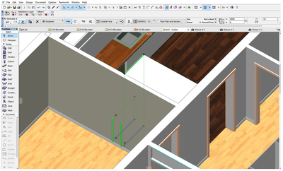

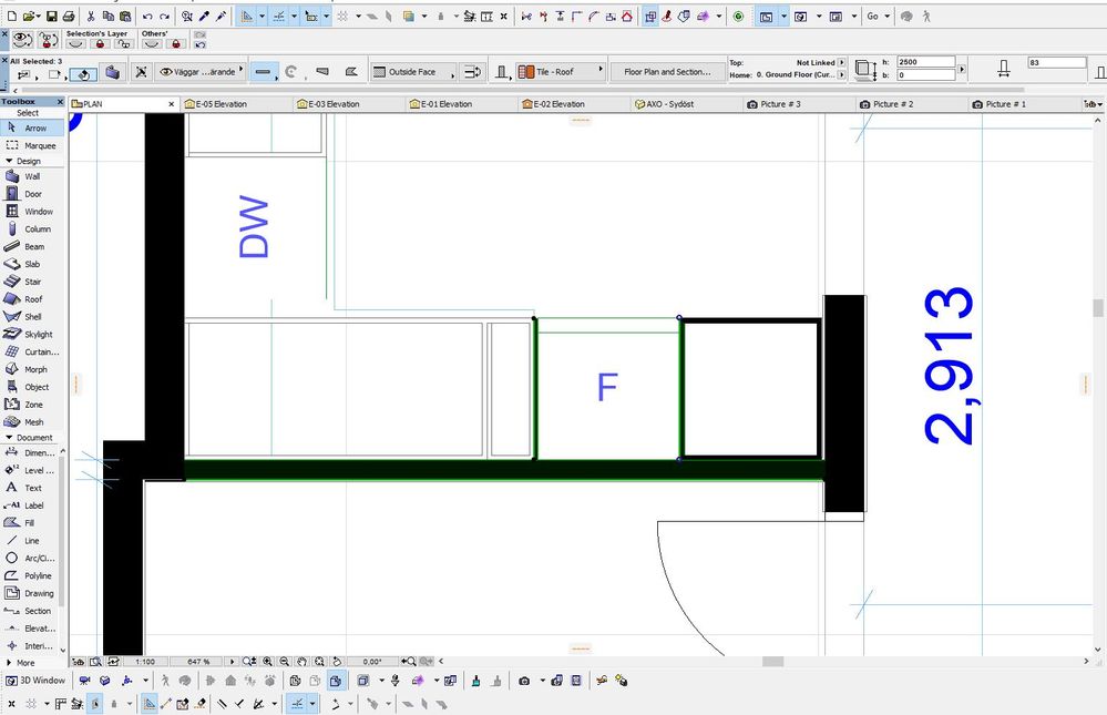

Walls different in 2D and 3D
DangCad
In one part of my model, I have three walls which looks perfectly fine in 2D (see screenshot, the selected walls), but when I switch to 3D the two thinner parallel walls are suddenly sticking out on the other side of the thicker wall (see screenshot 2). They are not intersected with the thicker wall or anything else. As you can see on Screenshot 2, it's not the full height of the walls that are sticking out on the other side, only up to a certain height.
What might be the problem here?

Solution
You need to either put them on a different layer that doesn't join or lower their intersection priority
Solution
Lingwisyer
Guru
If you want to build cabinetry using walls and such, I would advise that you put it all on a layer which has a unique Intersection Group. This will prevent it from connecting to any other walls it comes into contact with.
Ling.
3 REPLIES 3
Solution
Do I see it correctly that the thicker Wall is using a Complex Profile and has boards at its base? IN that case, I think what happens it the thin Walls extend to the outside surfaces of the Base boards so they stick out of the Wall's main body because that one is thinner.
Here is one idea: try to set the Intersection Priority Number of the baseboard's Building Material so it is higher than that of the smaller Wall's Building Material, see if that helps.
Solution
Lingwisyer
Guru
Ling.
