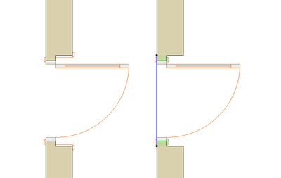

Hello!
I got sent a floor plan, that was probably made in AutoCAD, that has a reveal I cant seem to replicate.
I've spent like 2 hours trying to find a solution on how to make it but just cannot find a solution...
Can someone please help me 😫
Would be much appreciated! Thank you!

You can get that result by using the setting below but I think you will have an issue to get the casing the same, at least with a GS door. A quick solution to that is to split the wall and have a thinner wall for the door (shown to the right).
Solution
Yeah those settings are the best I've managed to achieve as well, it always seems to add extra casing on that inside wall...
The double wall trick will be the best solution it seems... Thank you!
