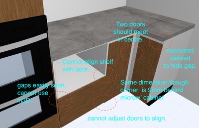

I have using AC25 Cabinets Tools for most of the day, and what a disappoint they are. I have only place in three cabinets, one cabinet is from AC18, because I need an oven. And the other 2 are unusable, refer image, the standard of this is not up to scratch?
There is functionality issues across the typical cabinet, they basically don't function like a basic cabinet. And with the corner cabinet there is a script with the Counter, Cabinet or Carcass command.
I do not understand how for every staircase made in Archicad, there is probably ten thousand cabinets. But the stair tool functions, ten thousand times better, while the cabinet tools should be ten thousand times simpler?

I have identified five which could be branched to many more, from only two modules, in one image. But I will DM a list as I keep playing, it could be long!
I must admit however, it is frustrating as a designer to still be in this situation with Archicad. To see still after many years, such lacklustre desire to create working functional joinery modules persists. It is as if Graphisoft think the Interior design is done, the moment the spatial plans is drawn?

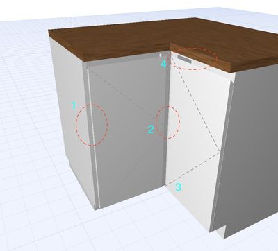

The Front Side Connection, I have selected flush; as you can see it is not. Make it an unusable function, need to add a wall to make an end panel. A waste of time.
2. These doors in a corner module should meet together, if you the designer wants them to. The workings of this Corner Unit needs some reviewing.
3. Just showing lines as they should appear in elevation, or in 3D if one wishes. With pivot (world) or hinge (Aus/NZ) options.
4. It is great having the Bevel/Finger-pull/Shark-Nose whatever you call it, has been 15year over due! But there should not be gap when applied. In my previous image, I display problems with door and shelf alignments. This is major problem in producing elegant tight work. If we can't show tight drawings, we are relying on Cabinet-Makers and Joiners to do it properly, and they never will, if we don't show it properly.
