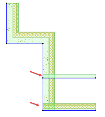

I have inherited an ArchiCAD 26 model in which composite walls will just not clean up based on materials priority. I am sure I am missing something obvious, but cannot seem to put my finger on it.
Per the screenshot below, a timber stud wall simply passes over a wall containing concrete without the materials interacting in any way, even though the wall reference lines touch.
The concrete material has a higher materials priority than the intersecting timber material, while the plaster board linings for each composite wall all have the same priority - so based on that I would expect the stud wall timber to be cut short by the concrete material , and the plaster board to heal either side - but that is not what happens.
The walls are all on the same story, and have the same 'new' renovation status.
Under Project Preferences/Legacy, walls clean up is not set to 'Legacy' mode (I tried it, and it does not help)
What am I missing here?
I have attached a module containing the walls, in case that helps.

2023-03-08 06:10 AM
Same Layer Group?

2023-03-08 06:20 AM
Walls in different layers with different (or zero) intersection group numbers?

2023-03-08 10:13 AM - edited 2023-03-08 10:20 AM
Bingo! Yes, the layer combo for the view had wrong intersection priorities set (freelancing for new office & with unfamiliar setup - suspect their template has been in use for quite a while and may even predate materials priorities being introduced into ArchiCAD).
Thanks guys!
