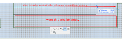

I want to close the top of the curtain wall with scheme grid shifting, but when it closed and reached to the right part, the area to be empty gets fill with the scheme.
I want it to stay empty while the upper part meets.
is it possible?
thanks.

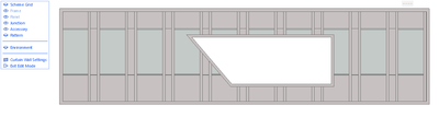

The Curtain Wall tool was modernized in Ac22 and the way we do things also changed.
Now you can simply go to Edit Mode, draw Frames around the intended hole, and then delete all Frames and Panels within that defined polygon, which will effectively create a hole in the Curtain Wall.
Prior to Archicad 22, it was done differently, in a Section/Elevation Viewpoint you had to extract the Curtain Wall boundary to a fill, modify the fill, then regenerate the Curtain Wall's boundary based on the modified shape of the Fill (Fill with a hole in it).
These commands still exist in Archicad, you can add them to your menu in the Work Environment Dialog. The commands are:
  • Subtract Fill from Boundary
  • Redefine Boundary from Fill
  • Add Fill to Boundary
However, I found that I did not manage to make them work in Ac25. So the commands may still be there but no longer work on Curtain Walls created in the latest Ac versions.
