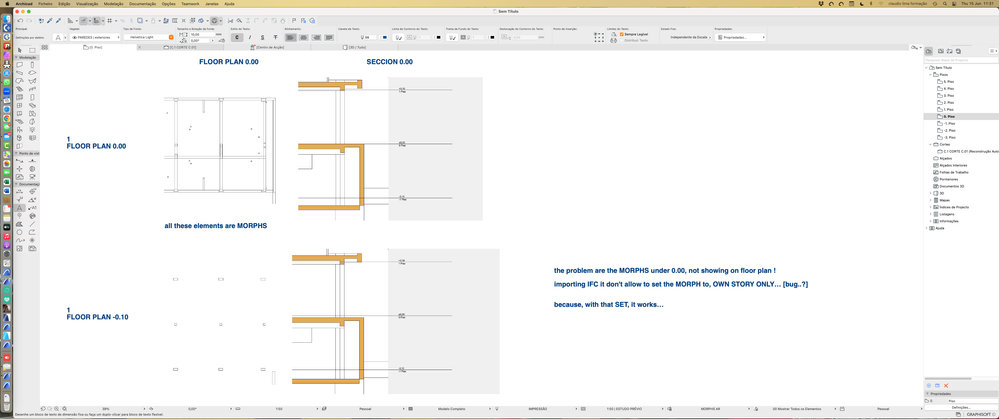

hi all !
I'm importing an STRUCTURE IFC as morphs, and the problem is :
the slab, the is below 0.00 floor , so it does not appear on the floor plan.
all the tests I made, I can make what I want but, not for IFC hotlink... ie, if the morph is set to ONW STORY ONLY, it works.
but, hotlinking the IFC, it doesn't allow me that option
any help ? idea ?
tnks
regards

2023-06-15 12:33 PM
hi mija !
tnks, but that's not the problem...., see the attach image, to see what im talking about

2023-06-22 02:39 AM
You tried to change the cutting level from floor plan cut plan dialogue by setting show down to the lower floor to GF by 0.10m, It works for me.

2023-06-22 01:07 PM
hi mahmoud !
please send me an image of that setting

2023-06-22 05:27 PM
Check this from Archicad help,
- Mark as New
- Bookmark
- Subscribe
- Mute
- Subscribe to RSS Feed
- Permalink
2023-06-22 06:25 PM
this I already know...., I was wondering why your file, was ok
