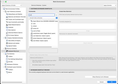

J_Tucks
Hmm looks like perhaps this is only available on PC. Here what I see from my keyboard shortcut options.

Yes, look for 'All commands in alphabetical order'.
If you look at 'Current menu structure', you will only see the commands you already have in your menus.
You need to search for ALL commands to find ones you don't have.
