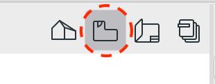

Hello laurac,
Are you sure you are using a view ? You screen capture does not show a view with parameters !
Views are on the second tabs at the right of the little house at the right top of your screen.
