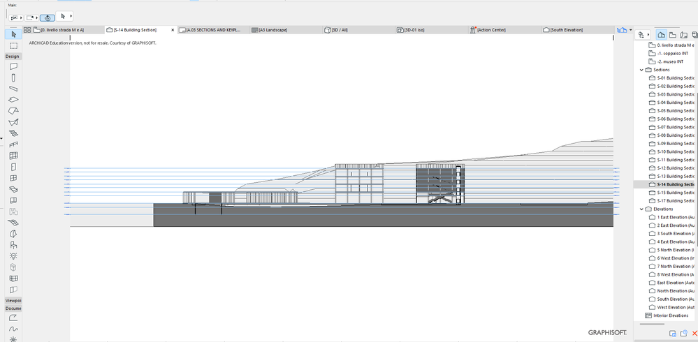

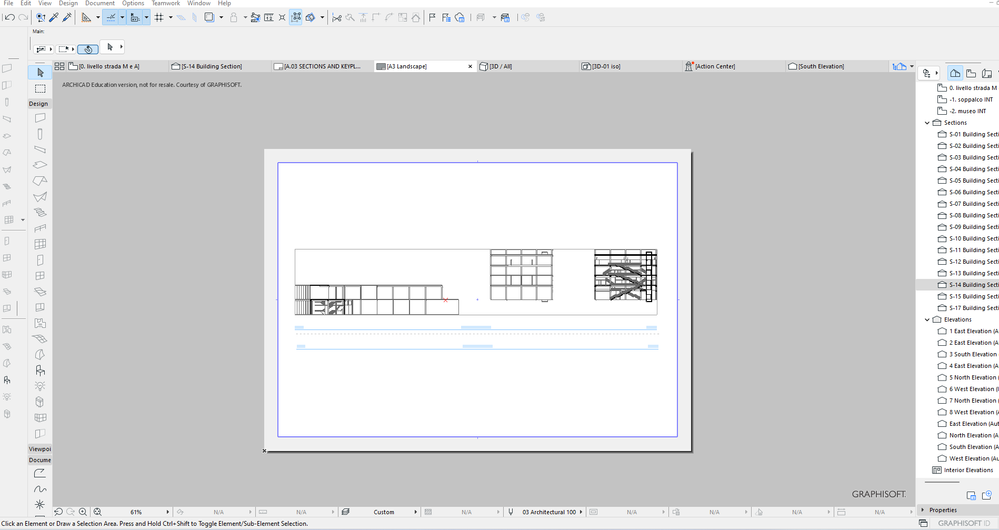

I've been modelling a project on a pretty complex terrain and with some perforated bricks. Both these elements show fine in all view ports, but when I put it on a layout they disappear. I've tried to extend the skirt length of the mesh past the lowest control point and checking the curtain walls' props but nothing seems to work. I've always closed and reopened the layout.

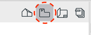

Are you sure you are using a view ? You screen capture does not show a view with parameters !
Views are on the second tabs at the right of the little house at the right top of your screen.
