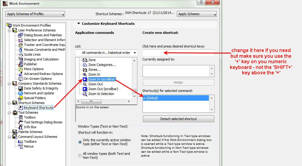

In the Archicad 18, I can hit the "-" key and it will zoom out. Supposedly, when you hit the "+" key it will zoom in. However, on a MAC I have to hit shift, "+". This doesn't work. I prefer to use keystrokes for everything. How can I get a keystroke for zoom-in? I can't find this function in the choices for creating keystrokes. Any solution?
5 REPLIES 5
I can't say specifically for a MAC but the command you want to change the shortcut for is "Zoom In (scrollbar) - not just "Zoom in" - that is the one where you define the window area on screen.
It should be set to this by default.
Make sure you use the plain '+' key on the numeric keypad if you have one.
Don't use the '+' above the '=' key as you need to press SHIFT for that one.
That is if you MAC has a separate numeric keypad.
If it doesn't that is why you have to press 'SHIFT+' as main key is '='.
The '-' works as that is the main function of that key.
Thank you. Not sure why I didn't see that before. Yes, my Macbook Pro doesn't have a numeric keypad or a "+" sign on its own. There are many functions with a Mac that takes 2 keystrokes where a PC just has one. A bit frustrating sometimes. Thanks much.
