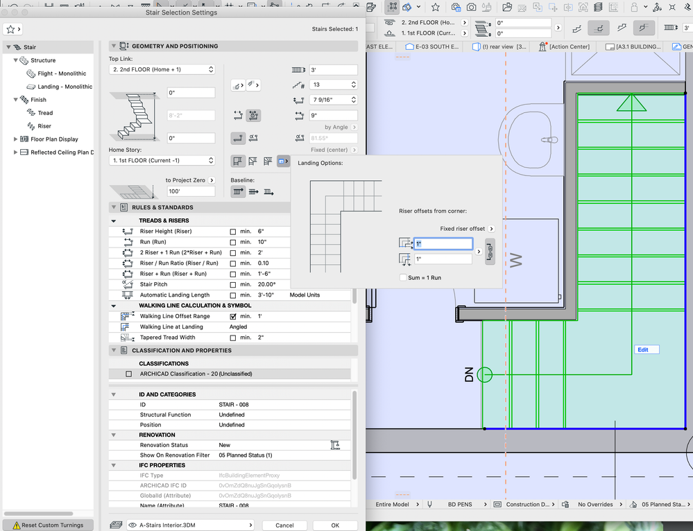

stair riser offset from corner landing
I am unable to edit the riser "offset from corner" of landing.  If I draw a new stair the offset works fine.  I guess I just need to draw new stairs when I want to edit this?

I have this same issue with the stair landing, is there any way that you can reduce that offset to 0 in the dialogue box, and then actually have the landing offset be zero on the modeled stair? Even after changing the offset, the landing still projects out towards the risers and adjusting the stair doesn't adjust this length.

I was surprised to see your post because this is actually working for me now.  Maybe try recreating the stair with the 0".  Make sure it is set to "fixed riser offset" not "mimimum riser offset"

Hello, has anyone found a solution to this apparent bug? Having the exact same issue. I do not view recreating the stairs as an acceptable offered solution for the value of the software.
