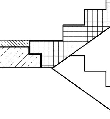

actually I am wondering, wether it's possivle modelling stairs in archicad with a seperate stairflight as precast concrete part and a stair landing made from in-situ concrete.
We need the following result in a section view:

‎2023-11-30 06:42 PM
probably best to model as separate parts. The best approach I have found with the stair is to not try to get it all done in one element.
Think about it like any other building element; you wouldn't try to model an entire elevation out of a single wall. You build it as it would be built in reality; platform framed with separations for material changes, thicknesses, finishes, insulation, etc.
The stair is no different. Just because you can model a large complex stair as a single unit, doesn't mean you should (at least not in all instances).
In this case, the BIM-ness of the model would indicate that the landing is a different thing than the stair. So the landing is modeled with slabs, beams, etc. Then the stair can be a stair for each separate string. You may need to play with the plan view setting a bit to get it to show up the way you need, but it's definitely possible.

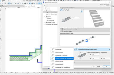

‎2023-11-30 07:34 PM
just uncheck this tick, to seperate stairflight and landing attributes
and theese settings for junction
final result
Archicad 27
Windows 11 professional

‎2023-11-30 07:36 PM
set your tread thicknes to 0
