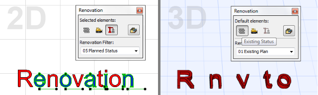

Elements are not visible in 3D view (renovation filter)
Issue
In some cases, the elements that were edited in the Floorplan view are not visible in the 3D window. It is also possible that you would like to edit a Marqueed Area of a Floorplan, but the 3D Window is blank.
Cause
One of the most common reasons is that the Renovation Filter is different on the Floorplan than in the Perspective View. It is a local parameter which means, that it can be set manually for all Floorplans, both 3D views, each Elevation, Section, Detail, etc.
Solution
When working with the Renovation Tool on the Project Map, it is always handy to keep the Renovation Palette or the Quick Options turned on. They can both help you to keep track of the current View Parameters.
We also recommend to use the View Map when the project begins to advance and various View Settings and Renovation Filters are used. I have highlighted those Parameters that may have a direct effect on the 3D window.
