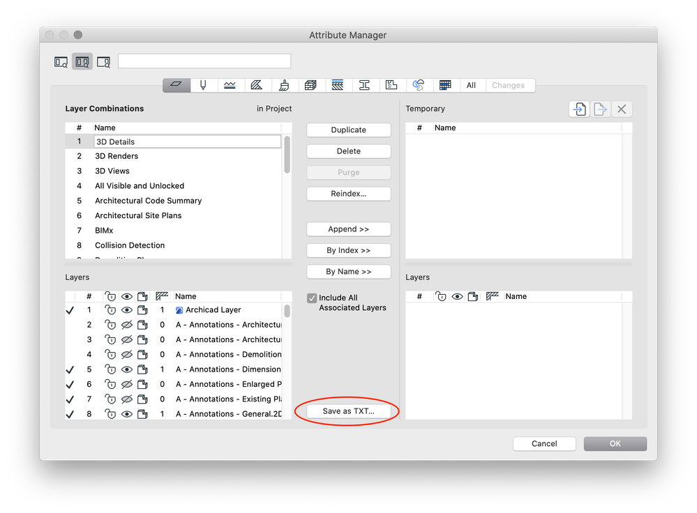

In V26 - What happened to the save Attributes as TXT?

Gary:
It is still there, but need to use the Attributes Manager... command rather than Attributes... command.
David

me bad - i was using A25 work environment and of course it did not display that option!!
Thanks for shaking my boat.

Thanks, @David Maudlin ... that button is so obvious I couldn't see it. How strange that the export button at the top right does not offer TXT as an option...

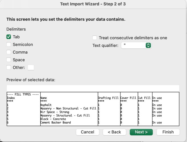

It seems totally bizarre that we can't export to excel.
Does Windows Excel not let you open TXT files and choose how to read the data into columns? This is part of what I see on Mac Excel when opening an exported list of Fills as TXT...

I have never tried that ---
Thanks
