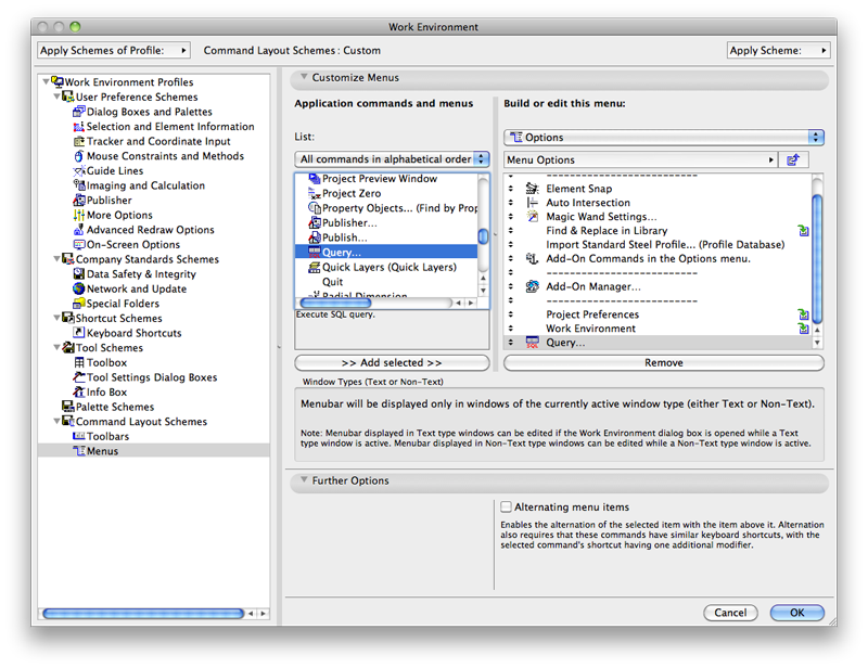

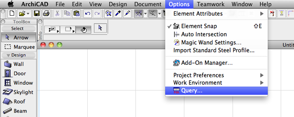

By default Query can not be found in none of the Menus.
  • Go to Options - Work Environment and add Query (it is easy to find it in All commands by alphabetical order) to a chosen Menu option.

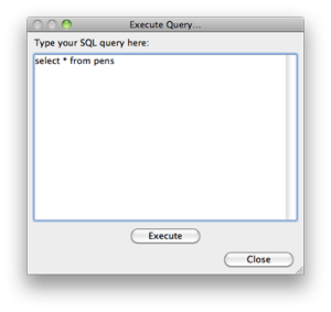

  • Enter a simple query select * from pens (without quotes) in the dialogue and click on the Execute button.

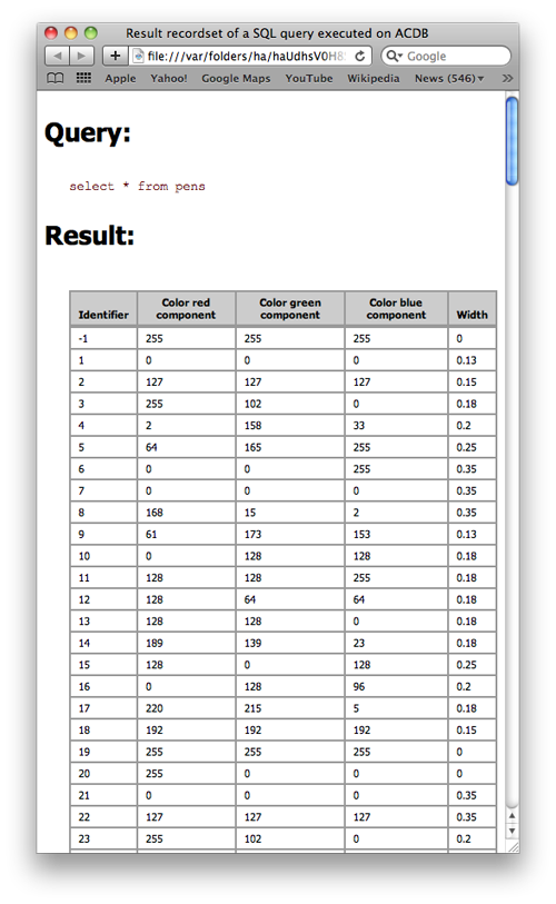

  • The result will appear in your browser similar to the screenshot below.
From here you can easily copy and paste the list to an Excel worksheet for further editing.
