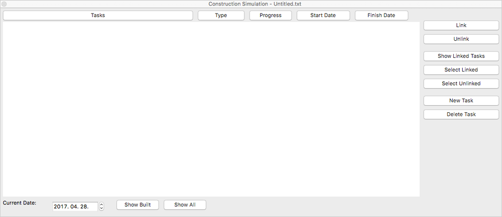

If you want to open an existing MS Project, go to ARCHICAD and choose the Document > Listing Extras > Construction Simulation > Open Project command. In the dialog that appears, select the file you just saved from MS Project. Click Open. If want to create your own Project in ARCHICAD, choose the Document > Listing Extras > Construction Simulation > Show Task List command. The Construction Simulation dialog box opens.

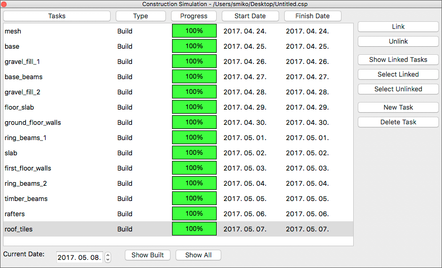

The dialog box includes the following fields: Tasks, Type, Progress, Start Date, and Finish Date. Fields can be edited by double-clicking in them. Clicking on any header will sort the task list by that key. The Tasks, Start Date, and Finish Date fields are imported from MS Project. You can either keep these or overwrite them, and you can manually enter new tasks. The Progress field is automatically filled by ARCHICAD to conform to the Current Date defined at the bottom of the dialog box. Otherwise, this field is not editable. Types are defined manually with a pop-up menu listing task types. There are five types of construction tasks:
  • Build: Elements do not exist when the simulation starts. They are constructed during the task and then remain there.
  • Demolish: Elements are present on the site when the simulation starts. They are removed during the task.
  • Restore: Elements are present both at the start and the end of the task. Work is performed on them during the task.
  • Freeze: Elements are present both at the start and the end of the task, but no work is performed on them.
  • Temporary: Elements are not present when the simulation starts. They are constructed during the task and are removed at the end of the task.
For example, here is what a finished Project Task would look like:
