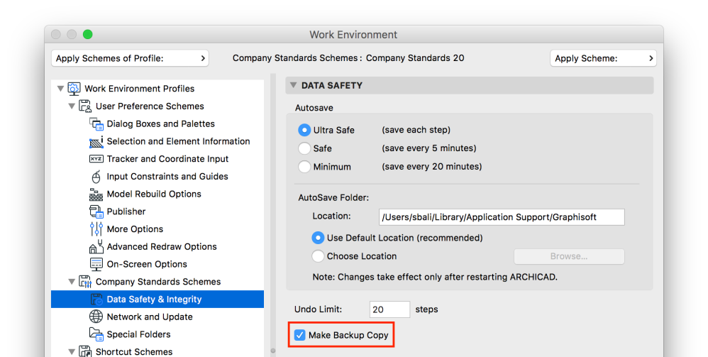

Backup files
These are automatically created copies if the corresponding checkbox is checked in the Data Safety panel of the Work Environment/Data Safety and Integrity… dialog.
Every time you save your project file, a BPN format copy of the previously saved version of the file will be created at the same location. You can simply open and use these files to recover your project if the original PLN gets corrupted or damaged. Save your files frequently to minimise the differences between the PLN and the BPN copy.

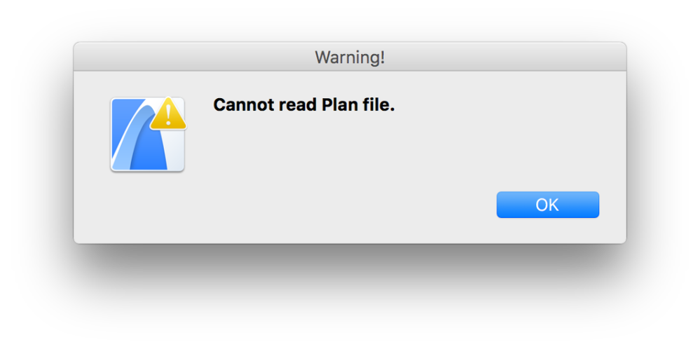

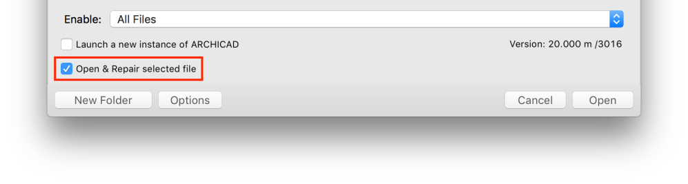

Corrupted files (Open and Repair)
In some rare cases your file might get corrupted due to a power outage or a hardware error and Archicad prompts that the file cannot be read when you try to open it.
Close the warning dialog and try opening the file with the Open & Repair selected file checkbox checked.
In case the repair process fails, try recovering from the backup file and send the broken file to Graphisoft. However in most cases the damaged file cannot be restored.

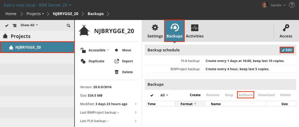

Teamwork Backups and Rollbacks
Using the free BIM Server this function is to save versions of the project automatically from time to time in PLN or BIMproject format. The first is the same as if the File/Save as… command was used on a client computer in teamwork, while the latter also saves the Teamwork related data (access rights, reservations, etc.) with the project.
Note: The File/Save command in Teamwork only updates the local data, it will not save an additional PLN file.
  • WIN: C:\Program Files\Graphisoft\BIM Server <version>\BIMcloud Server <version>\Projects\<Project Name>\Backups
  • MAC: System drive/Applications/Graphisoft/BIM Server <version>/BIMcloud Server <version>/Projects/<Project Name>/Backups
You can set the backup schedule or rollback the project to an earlier version from the browser interface of the Manager under Projects/<Project>/Backups, then Edit. If there are existing backups, use the Rollback option under Backups.
Note that this function will not prevent data loss in case of a hardware failure of the server for example. BIMcloud offers solutions for automatic data mirroring to external drives, but when using BIM Server you need to ensure that additional backups are created – copy the content of the backup folder manually every now and then or use scripts.
