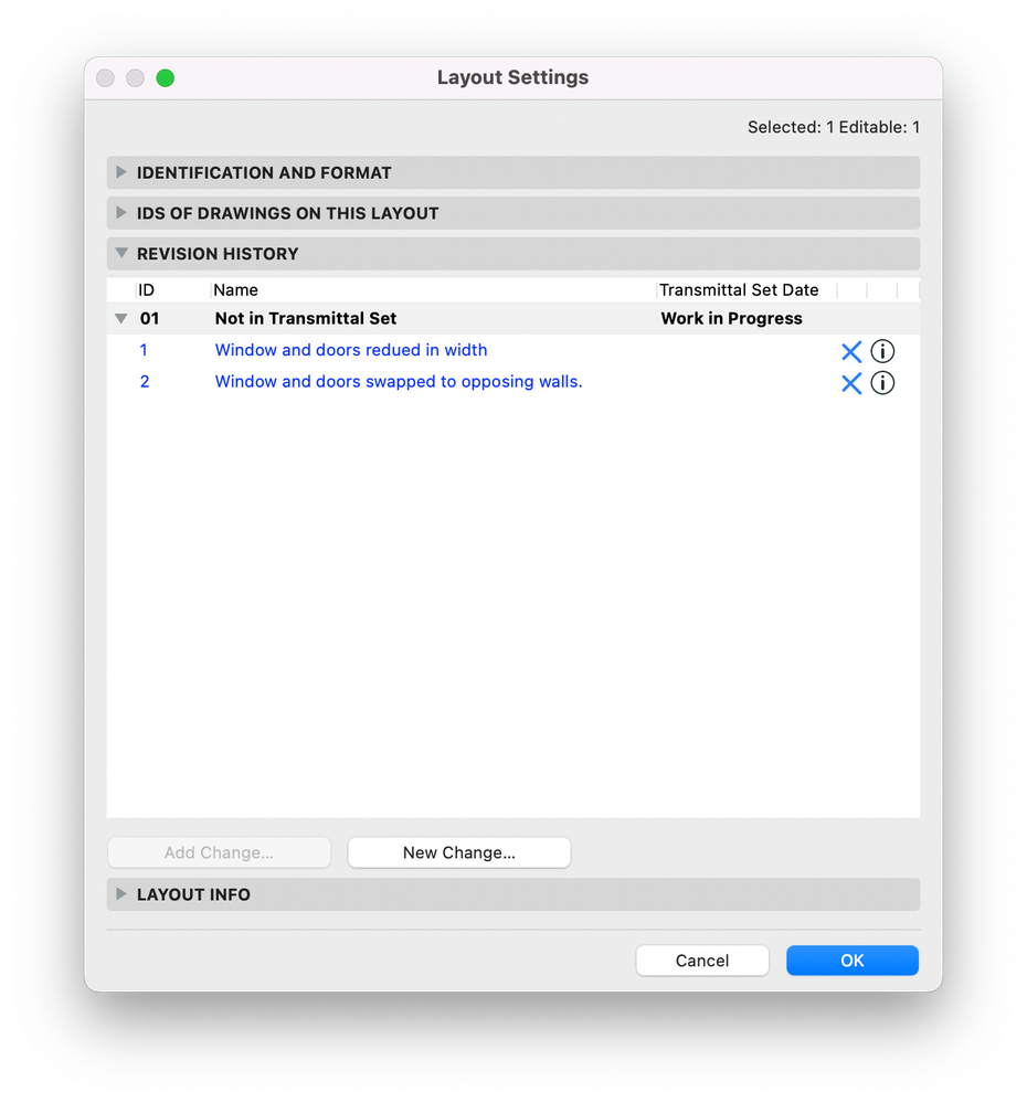

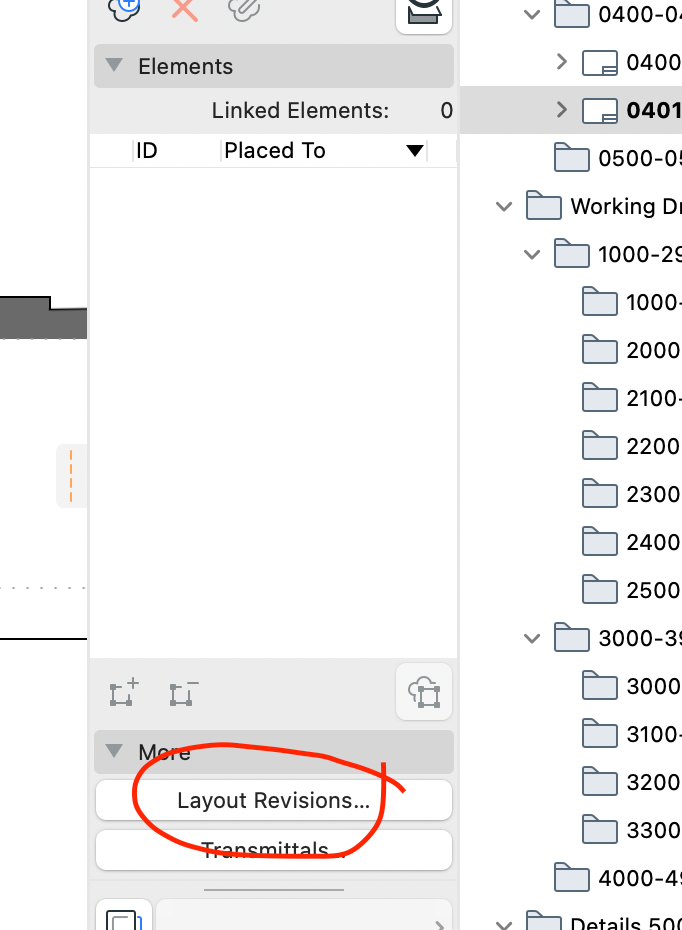

If you click Layout Revisions it will display all of the changes associated to the layout. You can delete them by clicking the cross.

‎2022-08-29 12:03 PM - edited ‎2022-08-29 12:03 PM
Yes, and that removes the text from the Revision History Object, but the clouds are still there, and that's the problem.

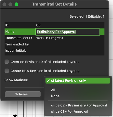

@stigbangkrogh Is this what you are looking for...
Show marker settings
More info available in Help: Managing Transmittal Sets

‎2022-08-29 01:57 PM
Hi, thank you for your reply. I am aware of this, but it doesn't remove the clouds as I would think is intended. I would think, like Lee, that when you remove the Change via the Layout Settings, then the clouds would disappear also, but this is not the case.

‎2022-08-29 08:47 PM
If the "New" layout with the partial view of "Floorplan 01" is in a new Transmittal Set on its own, then setting the Show Markers to "...latest..." should be hiding all the old clouds and this is a potential bug that should be reported through your local support if they are still visible.
If the "New" layout with partial view of "Floorplan 01" is in a new Transmittal set which also containing the existing full view of "Floorplan 01" with new changes, then those Views form a conflict of interests between the Change Cloud display requirements. AC will only rebuild the Drawing View once prior to publishing.
