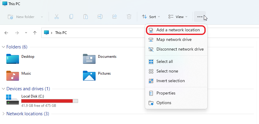

  3. On Windows 10: Click Computer tab and select Add a network location
    • On Windows 11, click See more button, then choose Add a network location

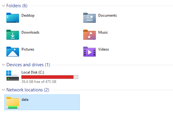

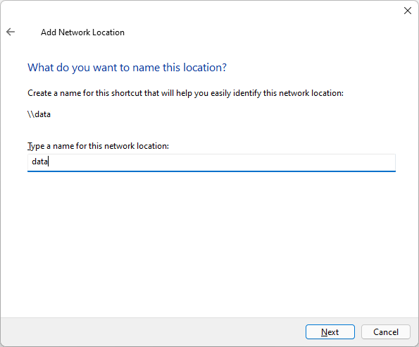

  6. Enter your network location or address (for example \\Data\Storage), or browse to your network location and click Next
  7. Enter a name for this network location for easier identification and press Next again.
  8. Once the path is successfully added, press Finish to close the dialog.
Under Network locations in File Explorer, the newly added address will be listed.

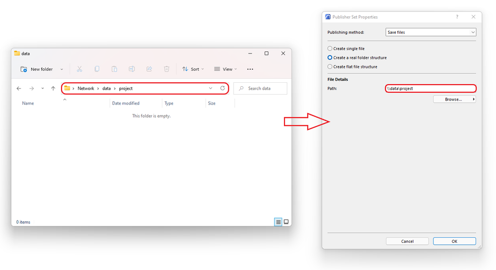

On Windows, the Publisher Set Properties uses a simplified version of the Browsing dialog to set the path. It can handle locations with mapped letters, but it cannot properly display added network locations. As a workaround, you can navigate to the given network location in File Explorer, then copy the address from the Address bar and paste it into the Publisher Set Properties manually.
