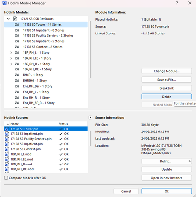

Hello,
See screenshot - I'm having trouble unlinking this project [Coul Hotel, which is a large file] from the one I'm working on [Achinchanter].
I'm trying to speed up the file I'm working on so want to clear anything I can to aid this.
Thank you.
1 ACCEPTED SOLUTION
1 REPLY 1
Solution
Use Hotlink module manager:
Select the link in the Hotlikned Modules and Delete:
Regards,
Scott
