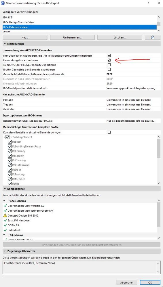

We have just upgraded to AC26 to realise that IfcBoundingBox export feature is missing from the IFC translator. Has this functionality been removed or is it now available somewhere else?
Thanks for your help!
Below I have attached screenshots from AC25 and AC 26.

I was just informed that since IfcBoundingBox is not part of the Reference View MVD, it is not going to be supported anymore. To be honest, Graphisoft, it was working fine, why did you have to remove it? Pls bring it back.
