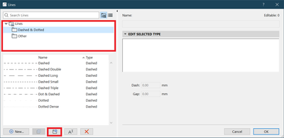

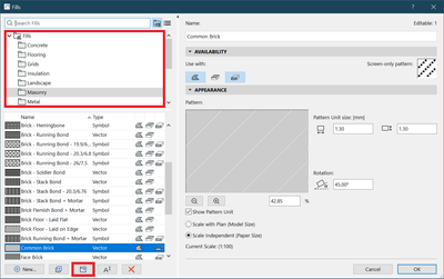

Folder organization and search bar for further attributes: Fills and Lines
The hierarchical structure of Fills and Lines can be created, managed, and applied using the same structure as other attributes, using the folder organization introduced in Archicad 26:
  • The structure appears on the Attribute palette, attribute dialog boxes, tool settings, and all interfaces where the attribute list appears, except the Attribute Manager.
  • The created structure can be imported and exported.
  • You can search and select already created Fills and Lines.
