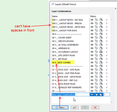

I am creating a new AC27 template, using my AC26 template as a starting point.
In the Layer Combinations, up to AC26, when adding a layer combination, you could add a "prefix" number to have your combinations show up in the order you wanted them to show up in the list. See the attached sample of my AC26 Layer Combinations.
However in AC27, when creating a new layer combination, no matter what numeric "prefix" I add to the name of the Layer Combination, the new combination gets moved way down the list, with no ability to order it or group it with other Layer Combinations.
Is this a new "Feature" of AC27 Layer Combinations? I hope I am just missing how to get the same type of results in ordering Layer Combinations in AC27 as was available in previous versions.

The difference in v26 and v27 is, that in 26 there was new dialog popping up. After naming your layer combination it was put in the right place (alphabetically sorted).
In 27 this new dialog is skipped and the new unnamed layer combination appears in the end of the list until it's named. Afterwards it'll be sorted the same way it did before. I just tried it in 27.2.0 Preview Version (Build 5001)

Technically now it is correct - but yes it is annoying when things like this change.
1, 2, 3, 4 should all come before 100.
It should not be 1, 100, 2, 200, 3 as it was before.
If we want it correct now we need to use 001, 002, 003, ..., 100, 101, 102, ..., 200, 201
Actually that changes nothing as 001, 002, 003, still comes before 100.
In my case, I need to change the 1 to 100, 2 to 200, etc.
So really, it is not broken now, it was actually broken before, and has now been fixed.

I don't think it was broken, I know it was broken.
I just didn't realise at the time, and worked with what we had - assuming that was just the way it worked.
Looking back at it now, it makes absolutely no sense to have a list that goes 1, 100, 101, 2, 201, 202, 3, 301,....
I wish it hadn't changed because it is going to be an inconvenience now moving forward.
So long as this order is consistent in all lists (including schedules - which I just checked and it is the same), then I think it is a good thing, and will adjust my template and carry on.
Fortunately for me, it will not be hard to manually adjust the few layer combination names that need to be fixed, or I can set up an attribute file that I can import to change the names.

OK, so now I am a bit confused.
The image you attached to your original post is for version 26?
What is different now in 27?
I replicated your layers and got exactly the same result - except you can no longer start a name with a space.
When I add a new combination following your naming procedure, it slots in exactly where I would expect it.
Can you post another image of the problem please?
Ideally, paste the image directly in the reply rather than attaching in the box below the reply.
Then the image will show directly in the post.

I understand why it is working for you from a NEW AC27 file. But, I took my AC26 template and imported it into AC27.  Unfortunately, every time I created a new layer combination matching the same numbering convention I previously used,  the new numbers would be inserted at the bottom of the list instead of where it should be numerically. And as you noticed, you can't have a space in-front of the numbering anymore. Again, that created more issues for our current numbering system. Now we have adapted a new numbering system that works with AC27.
I imported my AC26 file into AC27 instead of starting from scratch because there was just too much to redo, especially given how busy my workload is right now.
I appreciate you trying to help figure this out. But I have already started renumbering our layer combinations.
My gut feeling is the reason this all popped up is because I imported an AC26 file into AC27. My hope is when AC28 gets released, the numbering system remains the same.
